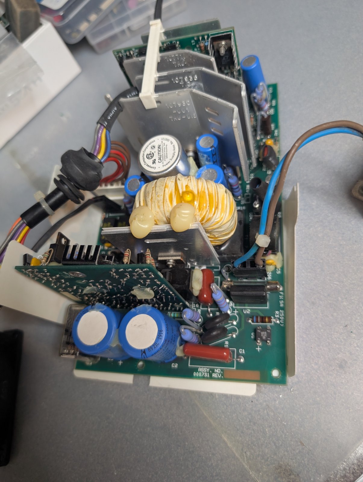

Bit of something different today from my usual fixing.
This is a PSU that gives out multiple different voltages but not until the "safety" circuit has been made.
As it turns out the PCB next to the two big caps is where the safety circuit and PSU fan voltages are created. It took me a while to find it but there was a shorted out tantalum cap right in the middle of the board. So now the fan spins up when the PSU is powered on, so time to reassemble it and try it back in the computer.

Beware the magic smokePhilC wrote: Tue Aug 25, 2026 4:43 pm Bit of something different today from my usual fixing.

@rubber_jonnie no magic black smoke yet.

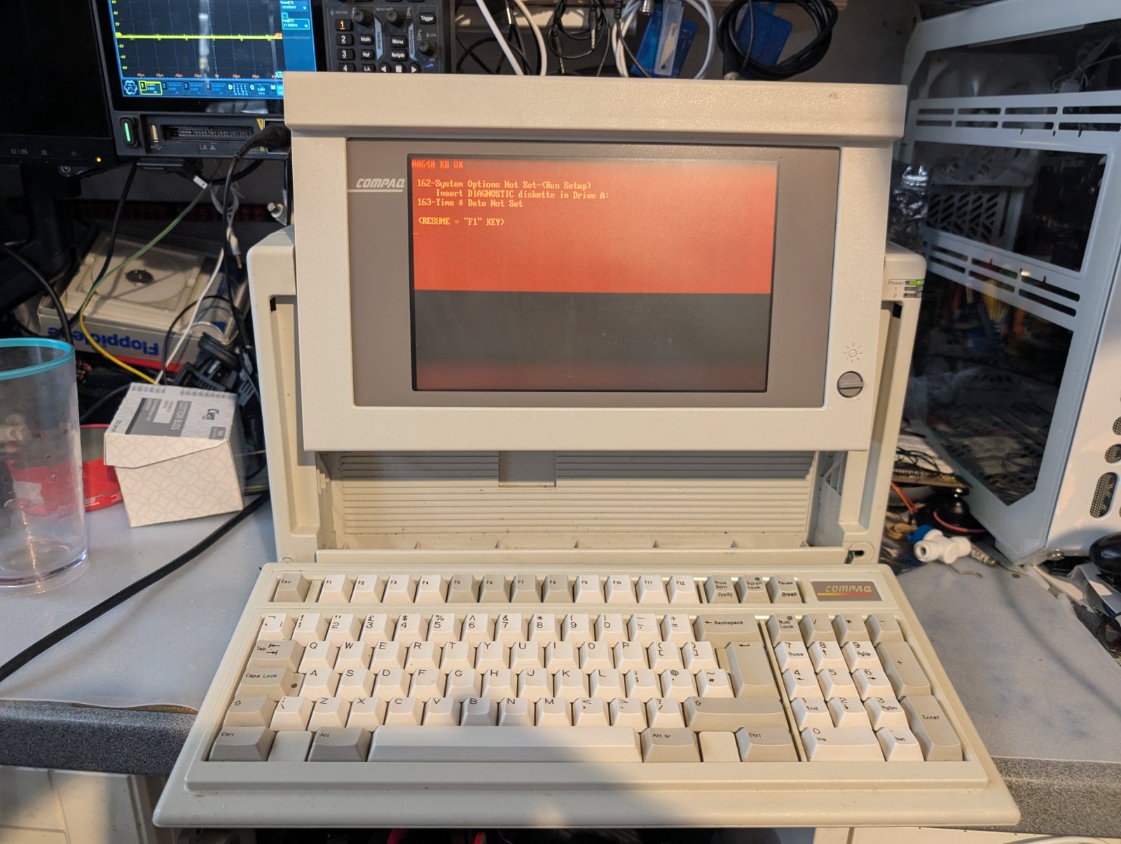

And this is what the PSU is connected to. Always had a bit of a thing for Amber monitors and this fits the bills nicely.
Just got to try and make some Setup disks for it now.

Nice machine @PhilC
What exactly is it?

@mrbombermillzy it's a Compaq Portable III. It's a bit beaten up, with cracked case and the 386 keyboard on it rather than the 286 one but that fits with my type of collection, working but had a hard life, just like me
It's a 286 PC, 5 1/4" floppy, hard drive of unknown size right now but all seems to work now.
It just needed a whole load of tantalum caps replaced on the PSU and motherboard.

I think it might need a little more ram, let alone the fact that it's got a CGA displaymrbombermillzy wrote: Tue Aug 25, 2026 7:18 pm Im pretty sure thats what he used to bring home. First time he brought it, I thought it was a plastic cased sewing machine.![]()
