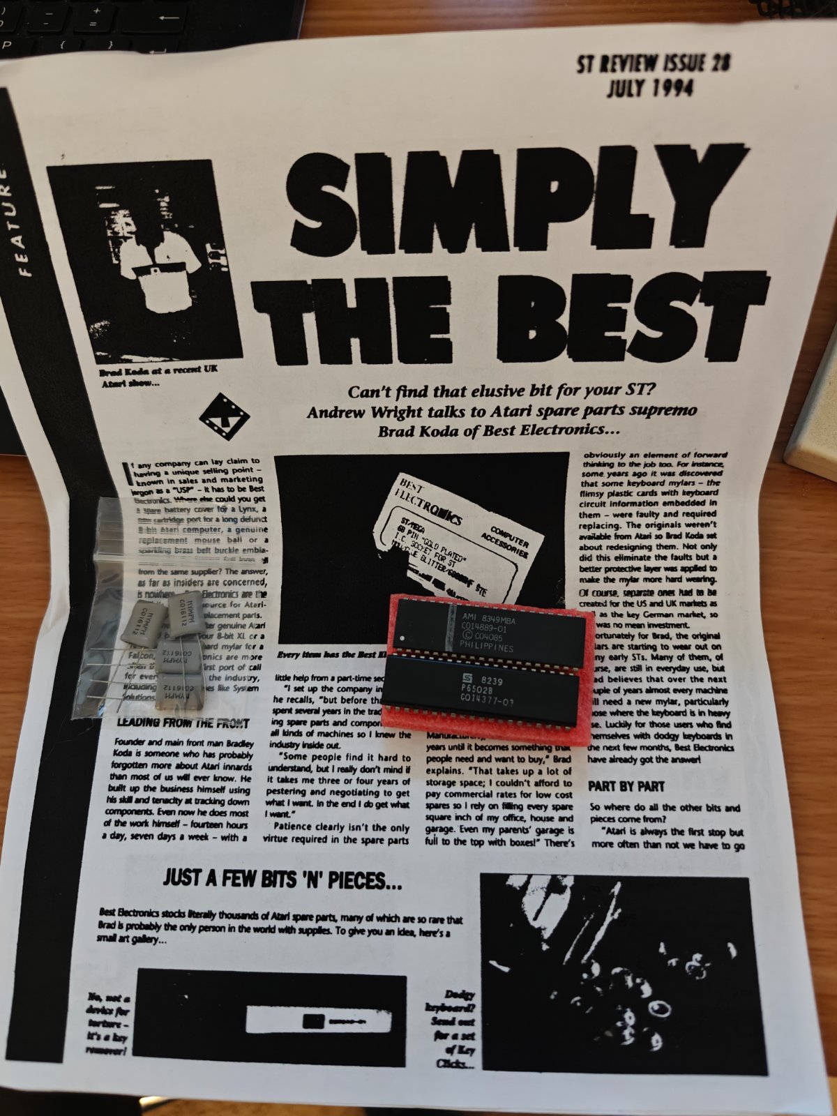

So I'm going to get back to the Si5351 shortly, but I had a care package from Best today:
And in it was a PAL GTIA, Antic, 6502B, 6502C (Sally) and four PAL 3.546894 MHz crystals.
So I'm going to get the 800 verified as running with known good parts and then start my experiments proper with the clock generation using an Si5351 board.
If I can get it working with 3.546894 MHz I may also add in the 4.433 Mhz clock too just for fun. I have an ATTiny board coming that I can use to program the SI5351 at boot time since it has no means to retain settings, but I can use a microcontroller to squirt the necessary code at it on power up.
First I have a minor repair to do for the switch harness from the mainboard to the power board though as there is a bit of trace damage and 3 out of 4 wires just disconnected themselves!!!
I need this fixed for the Option, Select, Start and Reset buttons to work. No Help on the 800 & 400.
First having a coffee and one of the few remaining mince pies in the house
