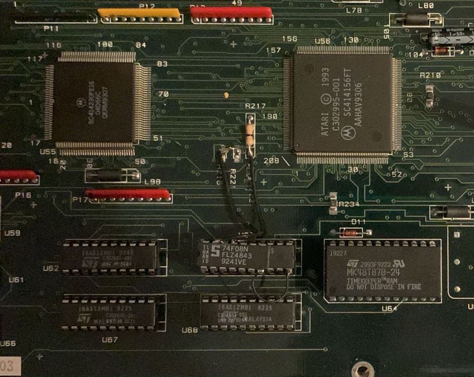

exxos wrote: Wed Jul 17, 2024 2:11 pm If you move the PSU out of the way, you can probe the fpu clock pins from above as shown in my investigation.The ct60e might be in the way though..
You mean here? Second pin from the top ?

Swissfalcon wrote: Wed Jul 17, 2024 6:29 pm You mean here? Second pin from the top ?
Yes.
