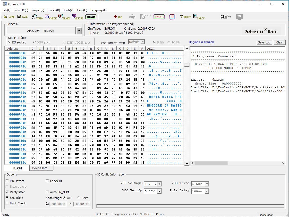

Having a TL866 is great for burning EPROMS for retro machines, but one thing it can't cope with out of the box is reading 23xx series mask roms to verify their contents.
I figured that it should be simple enough to make an adapter because I already have some adapter boards that convert 27xx to 23xx pinout so that I can put burned roms into machines. By using some pin headers instead of a dip28 chip, and a ZIF socket instead of the 2 rows of 12 pin headers effectively this should mean I can read a 2364 mask rom by selecting any 27C64 as the device in the TL866 (disabling pin check & identification), and reading.
So here's the little carbuncle that I came up with:
And it works... here's a C64 kernal ROM read with the TL866 software:
Just thought this may be useful for those of you doing diagnosis of retro machines - rom dumps for most machines are available online so it's quite simple to verify them.
