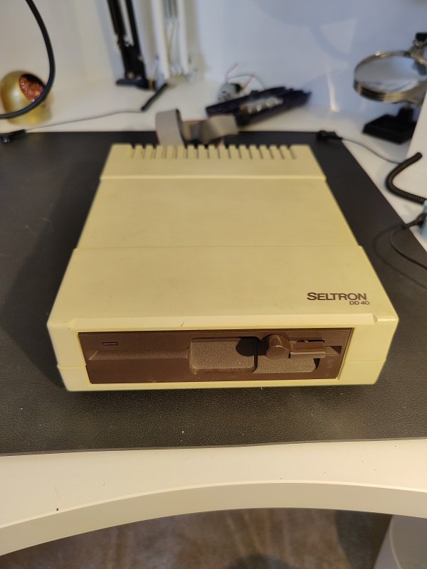

My next purchase floppy wise off eBay for £30 was this:
The drive itself seems to be in overall great physical condition, bar some yellowing. The case is very solidly built and was made in 1983 by VTL. Serial number is 110060. As usual for something from this era, shielding is completely over the top!!
The DIN plug is 5 pin and seems to be factory fit. 5v & 12V can be found at the socket when connected to my Apple ][e. I suspect if you had it connected to a machine that didn't provide power via the floppy controller (Is there such a thing in the world of Apple?), it would act as a power in connector.
Mechanism is manufactured by Sankyo. The belt seems to be in good condition, not slimy or melting, but dry and nicely tensioned.
If I connect it to port 1 of the FDD controller, it tries to boot, though I don't have a suitable boot disk. I did try to copy a disk from my Floppyemu to a blank unformatted 5 1/4" disk, but it kept showing write fails. A disk speed test also came out very odd, but these problems could be simple to solve since there is very little on the PCB, just 6 ICs 2 of which are 74LS series. Also, I'm still trying to work out what I'm doing having owned the machine for about a month and the FDD since yesterday

The Apple floppy controllers I've seen on-line all seem to use standard Shugart (edge connector) cables.

Not this one!!stephen_usher wrote: Mon Sep 06, 2021 3:51 pm The Apple floppy controllers I've seen on-line all seem to use standard Shugart (edge connector) cables.
It is a super simple mechanism, stepper seems to work and the disk spins, but it won't init a disk (write fails) and RPM is not good, so I will start there.
Really nice drive in terms of construction though. The 20 pin IDC connector fits the homebrew FDD controller just fine and the drive gets 5v/12v no problem, just not working properly.
Once I figure it out I can write or copy a disk and see if I can boot from it.
