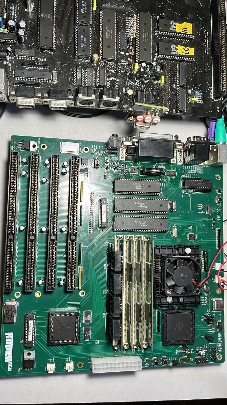

I start my RAVEN and i have issues.
It's hanging often my proc is 68060 rev.6.
I also have a question, at what frequencies does your processor run and what partition sizes do you use to make it run stably?

TKSM wrote: Mon Mar 24, 2025 4:11 pm I start my RAVEN and i have issues.
I can't really help with any of your questions, but I will point out your program counter on that crash screen is the first four bytes of TOS 2.06 ergo at some point your OS is likely tying to jump to a null pointer.
Are you using the correct OS?
Welcome to the Raven 060 club.
Do you have J106 jumpered? It also looks like you have the Front LEDs header jumpered. I have J106 jumpered and nothing on the Front LEDs header.
In terms of the frequency, I have a 48mhz OSC https://au.mouser.com/ProductDetail/815-ACHL-48-EK This means x2 the CPU is running at 96mhz. My CF card has a boot partition of 256mb

kodak80 wrote: Tue Mar 25, 2025 8:36 am
Jumper J106 ? To me it appears reserved and I left it open... what should it command ? :)

luciodra wrote: Tue Mar 25, 2025 9:18 am
I have J106 jumpered on both my Raven boards. It is noted as reserved in the docs but not sure what is does and why I have it jumpered. @agranlund might be able to confirm which is correct.
