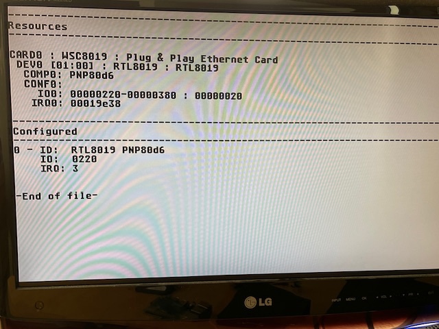

Maybe stupid question. But how do I use that uip tool. Does it need some arguments as it does not seem to start. Just got this network card but maybe it is not supported or so…

Oldskool wrote: Sun Mar 16, 2025 3:42 pm Maybe stupid question. But how do I use that uip tool. Does it need some arguments as it does not seem to start. Just got this network card but maybe it is not supported or so…
Not a stupid question at all.
Put this line in C:\ISA_BIOS.INF should do the trick:
dev.WSC8019.RTL8019.io = 300
(uip is hardcoded to look at port 300 for a compatible card. This is me being lazy, I should really make it ask isa_bios first.
My only defence is that the mint ethernet driver we borrowed from Hades is also hardcoded for 300 so that's where the card needs to sit for now anyway. I'd like to update or rewrite that one too at some point.)

Thanks for the help!
I normally would not bother with network stuff but this uip tool is great.
Indeed very easy.
And it works now!!
