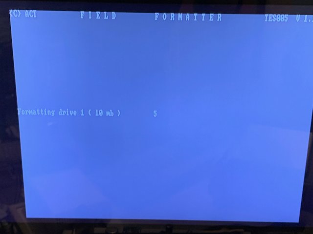

Changed the header pins and the hardware is now reliable.
Got a little further. The system now reads the first sector of the "drive" and decides that it's not bootable.
I found the virtual floppy with the HD formatter on it and I've got it as far as trying to format the first track of the drive, but then it crashes. I'll have to work out what values I'm passing back incorrectly.

With the help of reading the BIOS source combined with the WD1010-05 data sheet I've got to the point where the formatter isn't crashing!!!
Whether it's doing anything sane is another matter. My other issue is that I'm running out of RAM, or getting very close to doing so.

I just realised that my disk file seek calculation code was totally bonkers so it's not doing sane things.
Hopefully whatever the formatter writes to the drive will all be contained within the first 16 sectors otherwise all bets are off.
At least I'll find out how many cylinders it thinks that it has once the format has finished. (Two hours so far and it's 2/3rds of the way through, and it's not speed limited by the Pico, it's the code in the Apricot which is slowing things down.)

Well, the answer to the question, "How many cylinders on a 10MB hard drive with 4 heads is... 306."
The writing did screw up so it was a useless image but that's OK.
Now I've fixed the issues I'm trying again, but with a 5MB "drive". It won't be perfect as my hard-coded values for the seek are based upon 4 heads rather than two but that won't matter in the short term. Once I know this works I can make a 20MB drive (6 hours format time!) and clone it for later.
