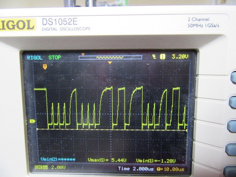

Currently its a very expensive beeper ! :lol: :D
Have a lot of activity on D1 now :)
Activity on D0-D2 (didn't check others) but a LOT of cycles going on now!

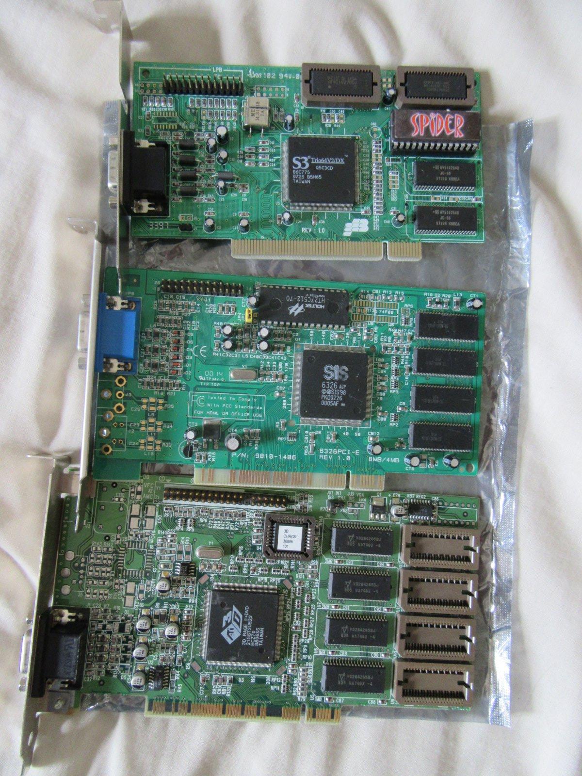

I could plug a graphics card in, but I don't know if any work at this point.

Id try and et4000ax graphics card if you've got one @exxos as those are the default for EmuTos and others. Even if you get a synced output you know you're going the right way
Posts: 29352
Re: Fixing my Milan 040 (or not) blog
PhilC wrote: Tue Jun 24, 2025 2:16 pm Id try and et4000ax graphics card if you've got one @exxos as those are the default for EmuTos and others. Even if you get a synced output you know you're going the right way
Uwe said a S3 trio chipset will work.. I have one of those and 2 others of what I can find..
