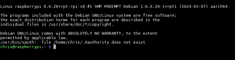

cd ../pistorm-atari
sudo ./emulator --config ../configs/atari.cfg
chris@raspberrypi:~/pistorm-atari $ sudo ./emulator --config ../configs/atari.cfg
[CFG] Set CPU type to 68020
[CFG] Setting platform to ATARI (sub: STE)
[CFG] Set CPU loop cycles to 300
[CFG] [MAP 0] Added rom      mapping for range 00000000-00000007 ID: EMUtos_Vectors
[CFG] [MAP 1] Added rom      mapping for range 00E00000-00E3FFFF ID: EMUtos
[CFG] [MAP 2] Added ram      mapping for range 01000000-08FFFFFF ID: ALT_RAM
[CFG] [MAP 3] Added register mapping for range 00F00000-00F0003F ID: IDE0
[INIT] CPU clock is 1800 MHz
[INIT] CORE clock is 500 MHz
[INIT] Using clock divisor 4.000 with PLLD
[INIT] GPIO clock is 125.000 MHz
Ran out of instructions :shrug:
I guess I will have to work on the PCB thingy next...
