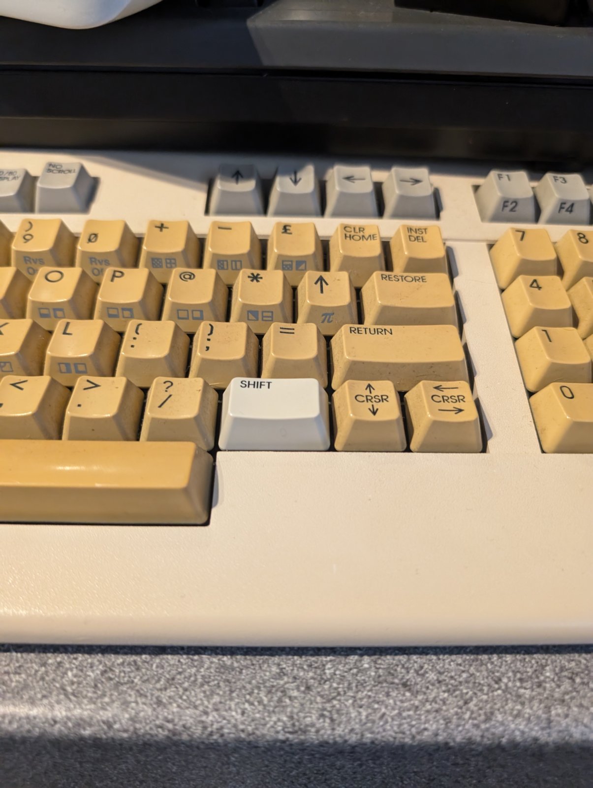

Still pottering around with the old retro stuff as and when the Cancer treatment lets me. I spend a lot of my time asleep or laying down thinking about retro stuff.
So today I've been doing a bit of retrobriting amongst other things.
So whilst I'm still trying to sort out these annoyingly pink Oric Atmos keys I threw in one of the C128 shift keys. And boy did it highlight the need to sort the rest of the keys out.

That's come out very nicely, I may have to do mine after the earlier ST and Electron success. Shame the weather here is a bit cold though as it's quite sunny.PhilC wrote: Mon Oct 07, 2024 2:32 pm Still pottering around with the old retro stuff as and when the Cancer treatment lets me. I spend a lot of my time asleep or laying down thinking about retro stuff.

@rubber_jonnie I do mine inn small batches using a takeaway food tray with one of those led nail lamps sat over it. Had to modify the lamp to stay on permanently, otherwise I'd be pressing the start button every 99 seconds
Got to find a better way to keep these keys submerged. Playdoh doesn't work, lol as I found out, Hydrogen peroxide is very good at resolving it.

What I do with my keys is put them in a ziplok bag, fill it with the water/HP mix and then as I close the bag expel all the air and lock it. It means the keys are pretty much submerged all the time and don't need holding down. I do occasionally let any gases out of the bag (You do get bubbling) and then reseal, and if outside I put silver foil under it to reflect the sunlight.PhilC wrote: Mon Oct 07, 2024 2:46 pm @rubber_jonnie I do mine inn small batches using a takeaway food tray with one of those led nail lamps sat over it. Had to modify the lamp to stay on permanently, otherwise I'd be pressing the start button every 99 seconds
I have considered getting a UV lamp setup so I can do wintertime retrobriting, wouldn't take much to set something up that I could leave in the garage for extended periods.
