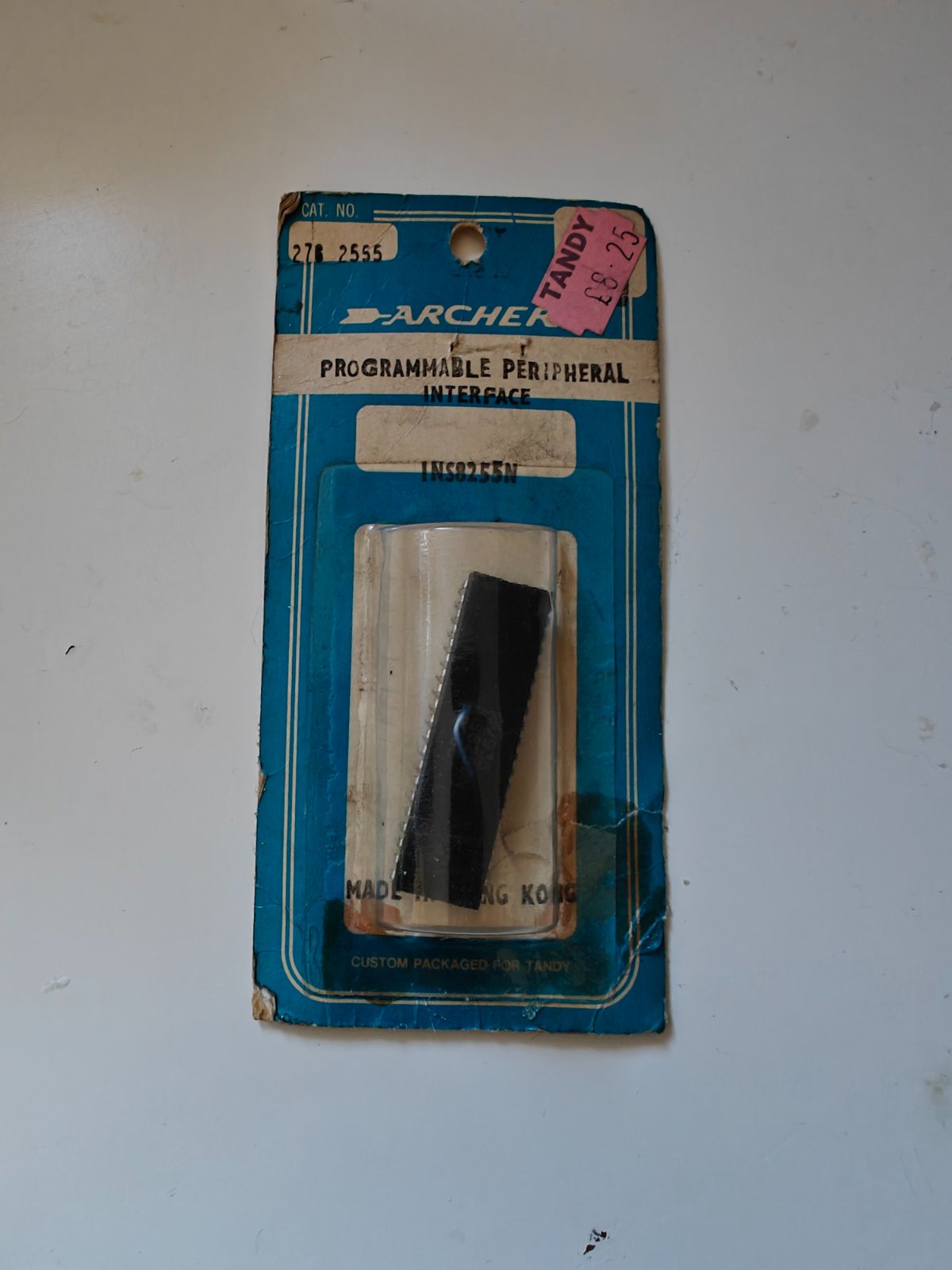

Re: Acorn Atom Replica build
Just for fun I thought I'd seal the bad one back in it's package for the sake of nostalgia given how much time I spent in Tandy/Radioshack when I was younger
I bought a lot of Archer stuff when I was younger, though never one of these

- Posts: 7643
£8.25 was a lot of money back in the 80s. Around £50-£60 now.
- Posts: 15419
I know, and certainly not the kind of money my younger self would likely have to spend on things I didn't know much about back in the day.stephen_usher wrote: Thu Mar 19, 2026 11:16 am
The date code on the Tandy piece is non existent, but the catalog number suggests around '83-'85. The new parts are '88 and NEC branded. Both worked fine, which was good for £7 for two
