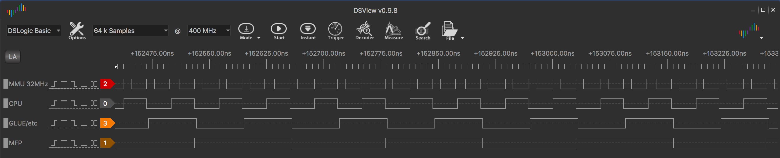

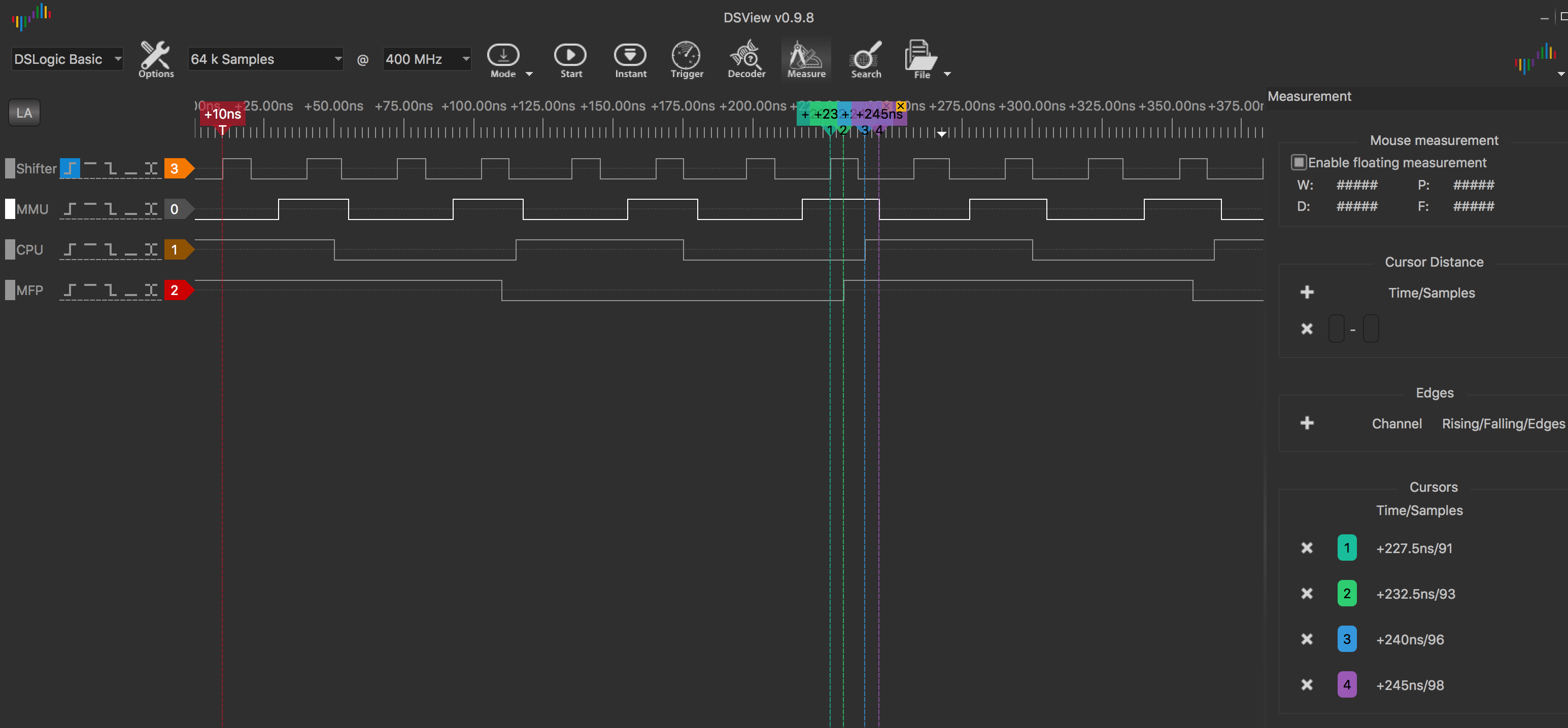

So here's what my LA sees when I look at the unmodified STFM. Clocks taken from Shifter (32MHz), MMU (16), CPU/GLUE/etc (8MHz) and MFP (4)
(I capture at threshold value 2.8V)

ah right, so this could be why there was a inverter? between the shifter and MMU clock.. I did wonder if the inverter was actually needed, I think I replaced with a buffer and I think it was just there to add some clock delay. As if you delay the 32mhz to the MMU by some ns then it would appear to sync to the falling edge of the clock instead. Though that could be a issue with just 1 GAL as I don't think you can daisy chain delays in a GAL like you can with normal LS series stuff :roll:
I'm a bit confused as to what is working with what timings currently... does it work with all the clocks generated from the GAL and in sync ?
