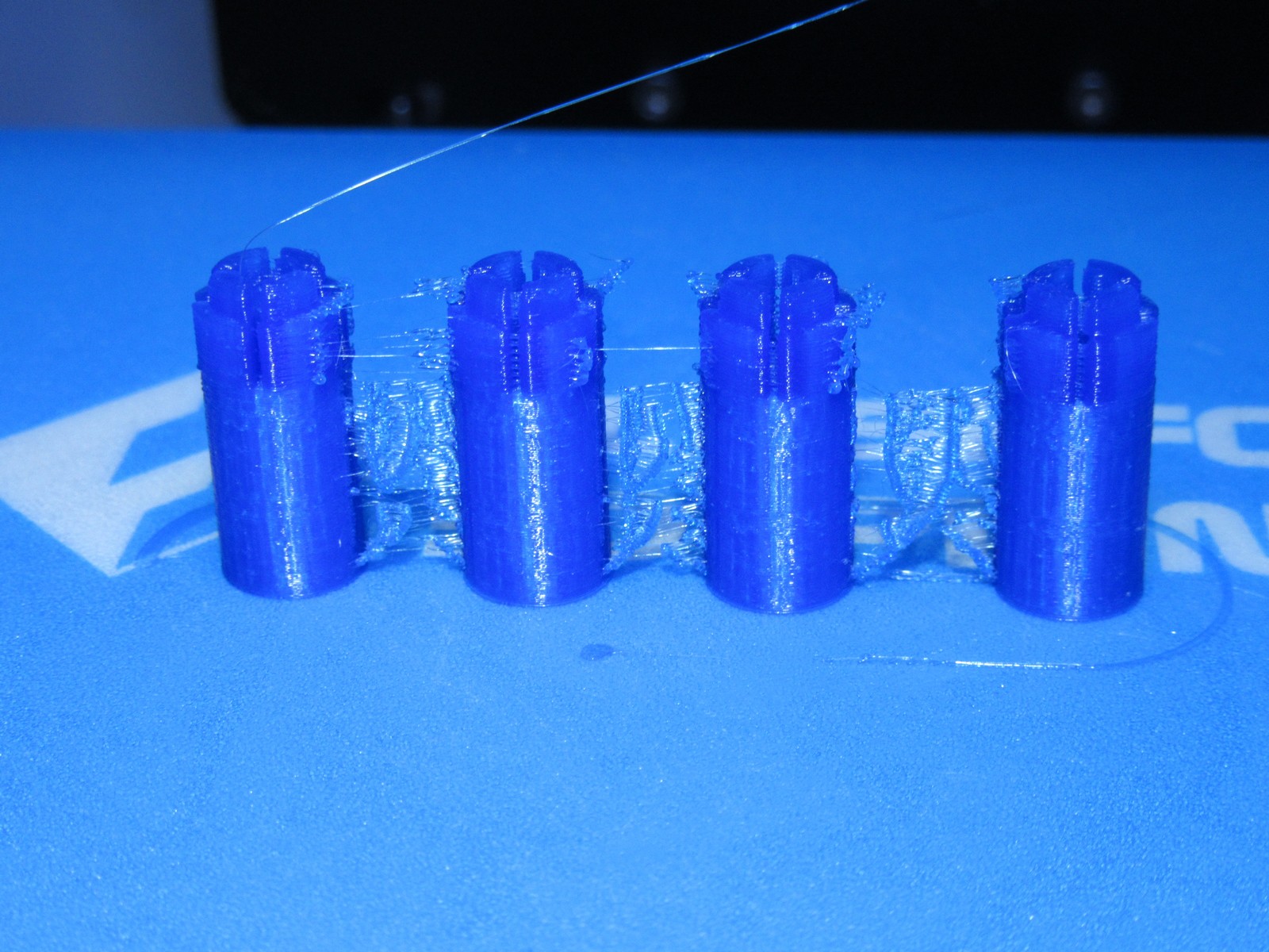

rubber_jonnie wrote: Tue Nov 20, 2018 8:38 am Just as a little bit of extra info, these print fine at .2mm, but at .1mm had some very fine stringing, and I know that exxos also had some print problems including stringing too.
.2mm is fine for most scenarios, but if you try to print finer and get stringing, then dropping the filament temp should do the trick. I was running at 200C, dropping to 190C or 180C should make it nicer. I'd also suggest perhaps printing solid rather than with infill.
I started with PLA and prints were terrible. I played around all day yesterday with it. Long story short, I had to move to 170c temp to get good prints. things were better with 0.2mm, but anything less my posts grew trees on the sides! I did 2 posts each test, and started to lower the temps 10c at a time. things were improving at 190c. 180c I was left with the slotted part (top) over hanging the main sides a fraction. now 170c gives me perfect prints. I will get my IR thermal probe on the head later and see what temp its really at..
Basically went from looking like these..
To these..

This was a test last night at 170C, 70C bed, .1mm layer, 20mm/s print speed and 200mm/s travel speed. There was some stringing still, but it was so super fine it was insignificant, and the posts printed out real well. I suspect if I put a bit more distance between the two I'd also reduce the stringing. It only happens up top when the slotted areas are printing, I suspect as it's got a lot more movement to do.
(Sorry for the large image size exxos, didn't think that it would show the detail smaller)
The only trouble, it took about an hour, so I think though I'll change my temps to 170C & 70C respectively, I'm going to stick with 50mm/s print speed and 120mm/s travel speed, with a .2mm layer for general usage, and use the other values for when I want the quality to be real nice.

Interesting, the article here: https://ultimaker.com/en/resources/1950 ... -stringing suggests an increase in travel speed and reduction in print speed, but you have a pretty fast print speed (Mine defaults to 60mm/s) and a slower travel speed (Mine defaults to 120mm/s).
I suppose it is all dependent on the printer too, you have a fixed bed I think, and mine moves, so that may play a part. I also suspect as you mentioned that the temps are not wholly accurate, so 160-165C may be feasible to use on mine, but I have no way of telling atm as no thermal scanner.
