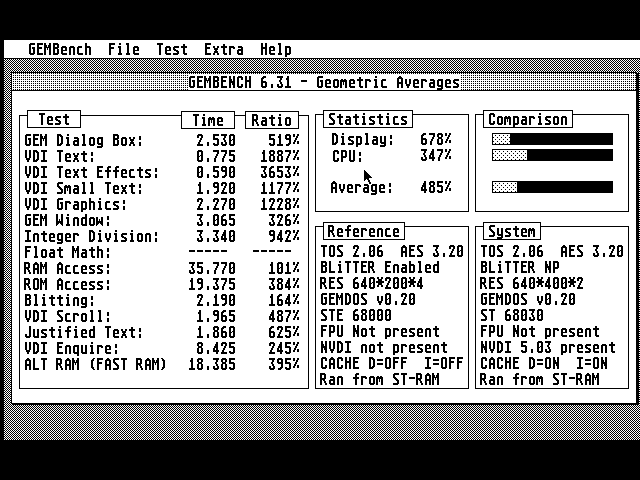

Another TF ST536 is up and running. First boot was with Emutos and Satan ACSI. I also tested the big 512K Emutos and it worked, but Gotek with FlashFloppy rom crashes in Emutos while booting autoboot.hfe (I like Emutos because of FAT support out of the box). This, together wih Blitter problem made me permanently switch to ST536 ROM. The speed of "27C4096 EPROM [0251]" from the Exxos store proved to be a non-issue, It just works(TM) :lol: .
IDE finally started working after I found out a working combination, for me 16GB Sandisk SD card works like a charm.
All in all, install was really straight-forward, besides SD cards compatibility.
Posts: 29346
Re: REV 3 - REV 5 - The beginning (ST536)
:bravo:
Not sure why EMUTOS fails but I don't think anyone has tested it much. You could report the issues on their mailing list..
You have GB6 running from ST RAM so it's giving you some lower than expected scores.
IDE is likely sulky with cards other than SanDisk. It's the same IDE code as used on Amiga cards and people tested without problems. But the ST with ""dumb" IDE interfaces which are the common designs don't generally work with any cards but SanDisk. It's why TRUIDE was designed for the H5 as it's a much more mature and tested design. I'll get them in the store again at some point...
