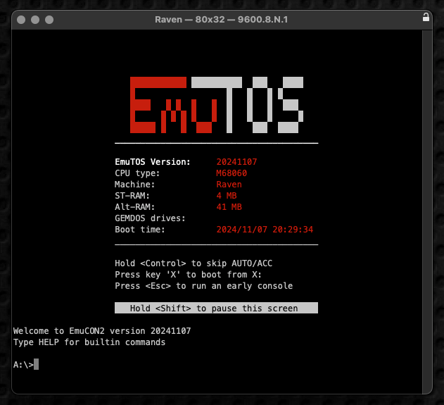

luciodra wrote: Thu Nov 07, 2024 6:06 pm Ym test performed successfully. Is there such a test for graphics card? Is there anything I can put in the CF for an IDE port test?
Nope there aren't any more built-in user friendly tests, though it would be nice to have more if someone wants to implement them.
Put the graphics card in and give it a try. If all is well you should get to the desktop with EmuTOS's built in graphics drivers and even with no CF card attached.
roms.zip
(420.41 KiB) Downloaded 26 times
(I changed the baud rate for boot messages / debug monitor to 115200 baud)
rom_mon.bin is the stripped down bootrom with debug monitor only.
rom_tos.bin is the full thing with EmuTOS.
rom_con.bin same thing but EmuTOS is built as console-only which you interact with over the second serial port @9600 baud.
That last build is more of a curiosity but perhaps it's of benefit to verify emutos boots, and maybe also if cf card works, even if you have no graphics.
CoolTerm might be unhappy with the EmuTOS's ANSI output, I used some other terminal for this purpose.
Screenshot 2024-11-07 at 20.37.22.png (76.98 KiB) Viewed 732 times

Ok, the ET4000 card gives me a black screen. It could be many things, but my doubt is about Narnia and Nessi, especially the first... :?:

luciodra wrote: Fri Nov 08, 2024 9:34 am Now I'm dealing with the fact that I have black screen video output.
Does "rom_con.bin" work in the sense that you get emutos booting to commandline?
(put the serial cable in the second, ST compatible, port and use 9600 baud)

agranlund wrote: Fri Nov 08, 2024 7:38 pm Does "rom_con.bin" work in the sense that you get emutos booting to commandline?
Maybe I don't quite understand how to use it, but I don't have the Emutos window that you have.
Could we have a debug rom like rom_tos_dbg2 that runs at 9600 baud?
