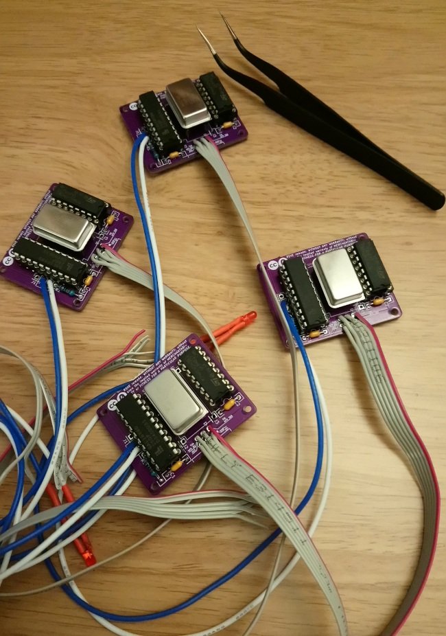

And now we wait...
A little shot just after inserting the ICs, but before putting polyimide tape underneath and putting in anti-esd pouch and packing...

Are these tested or are Darklord doing the testing?
Re: Recreating the RSVE mod…
They're...they're... beautiful!sporniket wrote: Sat Dec 17, 2022 10:11 am And now we wait...

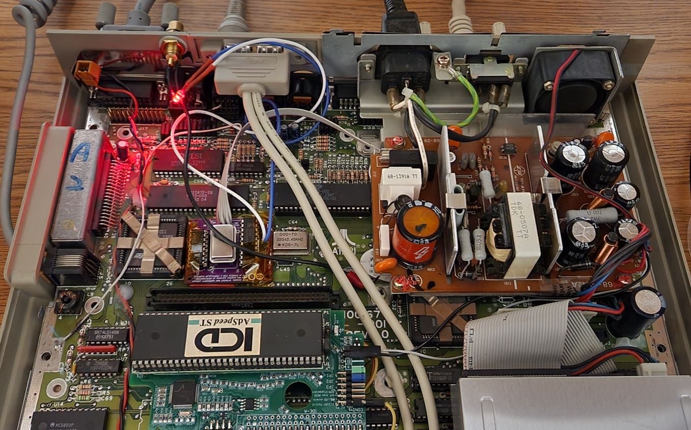

Okay, here's some pictures of my Mega ST4 with the RSVE mod in place.
The MFP chip is under the power supply on the Mega ST, so after you
strip it down, removing the RF shield, etc, you also have to take the
P/S out. After that, everything is readily accessible.
I just wanted to thank Sporniket and Exxos again for all their help with
this project.
Now that it's in place, I just need to get the Mega ST4, the WiModem232,
and the software all working correctly together. I hope that'll happen soon.
Mega ST4 stripped down to the motherboard:
There's the MFP chip in all its glory:
Here's where I decided to tuck the RSVE mod safely away to:
Here you can see the RSVE mod with the wiring in place. I put one ground on pin #36 on the
chip, one on the grounding plane of the motherboard (far right) and one joined with the
ground from the audio mod to the one of the screws that holds the P/S down (middle top):
And finally, you can see the red LED is lit up when it's running with the HSModem software
set to enable the RSVE mod:
this project.

I am glad that the parcel arrived safely. I cannot help at all about how it is supposed to work, but the fact that it is able to switch on/off the led when enabling/disabling the mod is encouraging. One thing to try, as silly as it seems, would be to maintain pressure on the oscillator package (the metallic case in the middle), in case the contact with the "socket" I made is not good enough to transmit the reference clock to the GAL.
That said, this is just theoritical, and the fact that you get something when you disable hi-speed shows that that fitting is correct too.
