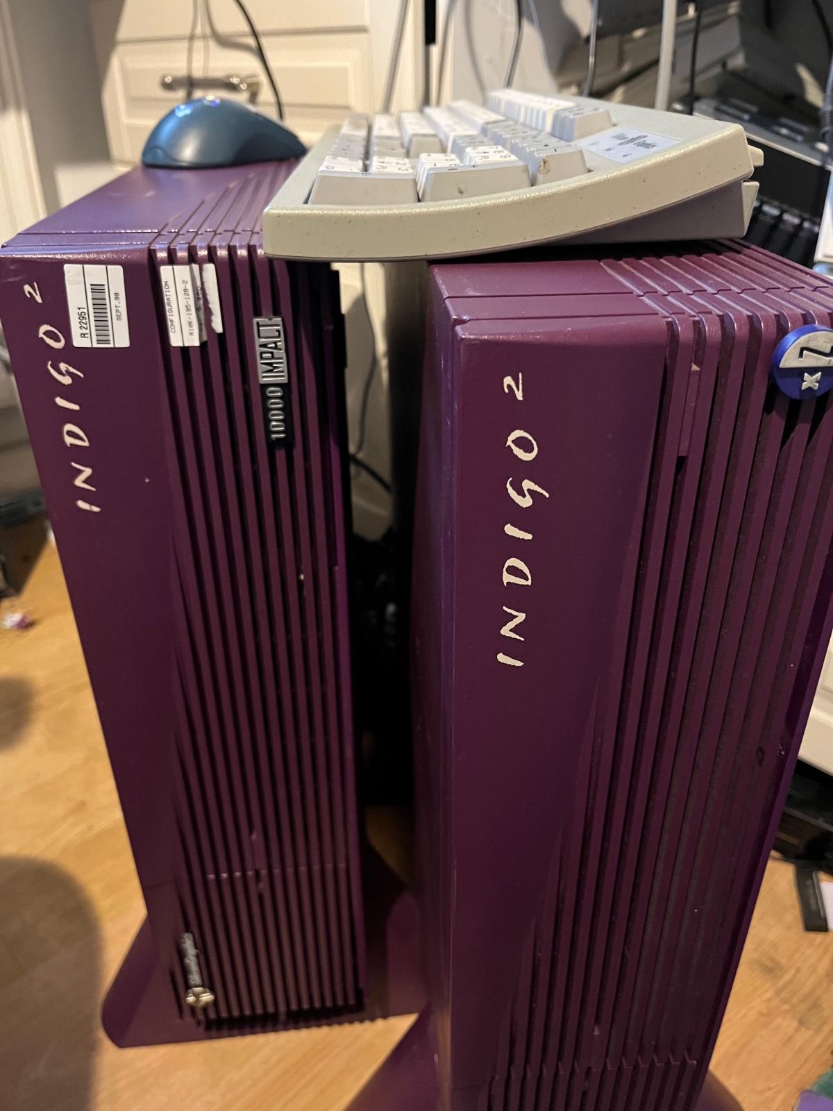

Talking about SGIs coming out to play I thought it’d be rude not to post a pic of the two Indigo 2s sat on the floor in the geek room.
The left one, an Impact 10000 was given to me by @Steve and wasn’t working but now is. The right one is an XZ with 384mb ram, 200mhz and was one I bought off of eBay to help me fix up the Impact.
So I did a bit of dry joint fixing in the PSU of the impact and took everything apart and reseated it and then put it back together.
Now what I’d planned to do was to get the scope out etc and see what voltages the XZ had on it during standby and then work through the PSU on the Impact and get that working.
Surprisingly the Impact went and booted up!
Anyway, I just need to get a 50pin SCSI HDD sorted for the impact and then it should be fully functional.
