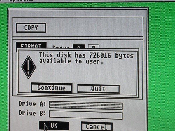

MAPROM_C version 22. REV5 ST536 TOS :
FCOPYIII formats 1.88MB fine.
GEM 720K:
EMUTOS 1.1.1 - but oddly MAPROM doesn't seem to be doing anything with it now :shrug: ROM doesn't seem to get copied to alt-ram. Also oddly EMUTOS is reporting TTram in KB not MB . It might not being launched from ST536 TOS which stuff already allocated :shrug:
GEM 720K:
