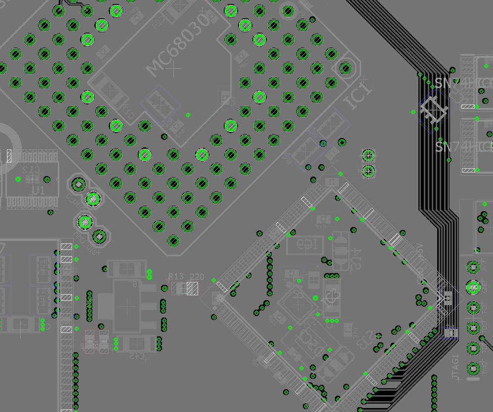

I tried with it lots last night. The only thing there is a GND track on the top layer which goes to the CPU ground. BUT in order for it to get hot must mean the inner layer ground "isn't there" and a massive current from the PLD is all going thought the same track. Even so it's a pretty wide copper fill... And every GND pin on the PLD has a via going to the ground plane.
Will post an image later to show what I mean. But while inner copper is thinner than top copper, the impedance of the entire ground plane would have to be higher than the smaller copper gnd fill on the top layer... Seems impossible.. But here we are...
There's nothing hotter than 43c on the underside. But there's nothing there other than 2.2k resiator packs. The heat isn't uniform near them anyway. The heat is only topside.
My only thought is maybe the cpu is negative spiking the GND and the PLD sees it as more negative than system GND. Maybe impedance is higher on system GND due to the vias from GND to the PLD GND pins.Top copper goes direct to CPU GND.
I'll have to try and cut that track to prove the hypothesis later...

Grey is copper gnd fill. The highlighted pads on the PLD are gnd points.
Then the top copper gnd fill..
So I need to cut that track to separate those GNDs next..
So that wasn't it then
I checked on the bottom of the board, nothing hot there.. it's all the same temperature..
I can only assume its some sort of measurement error
