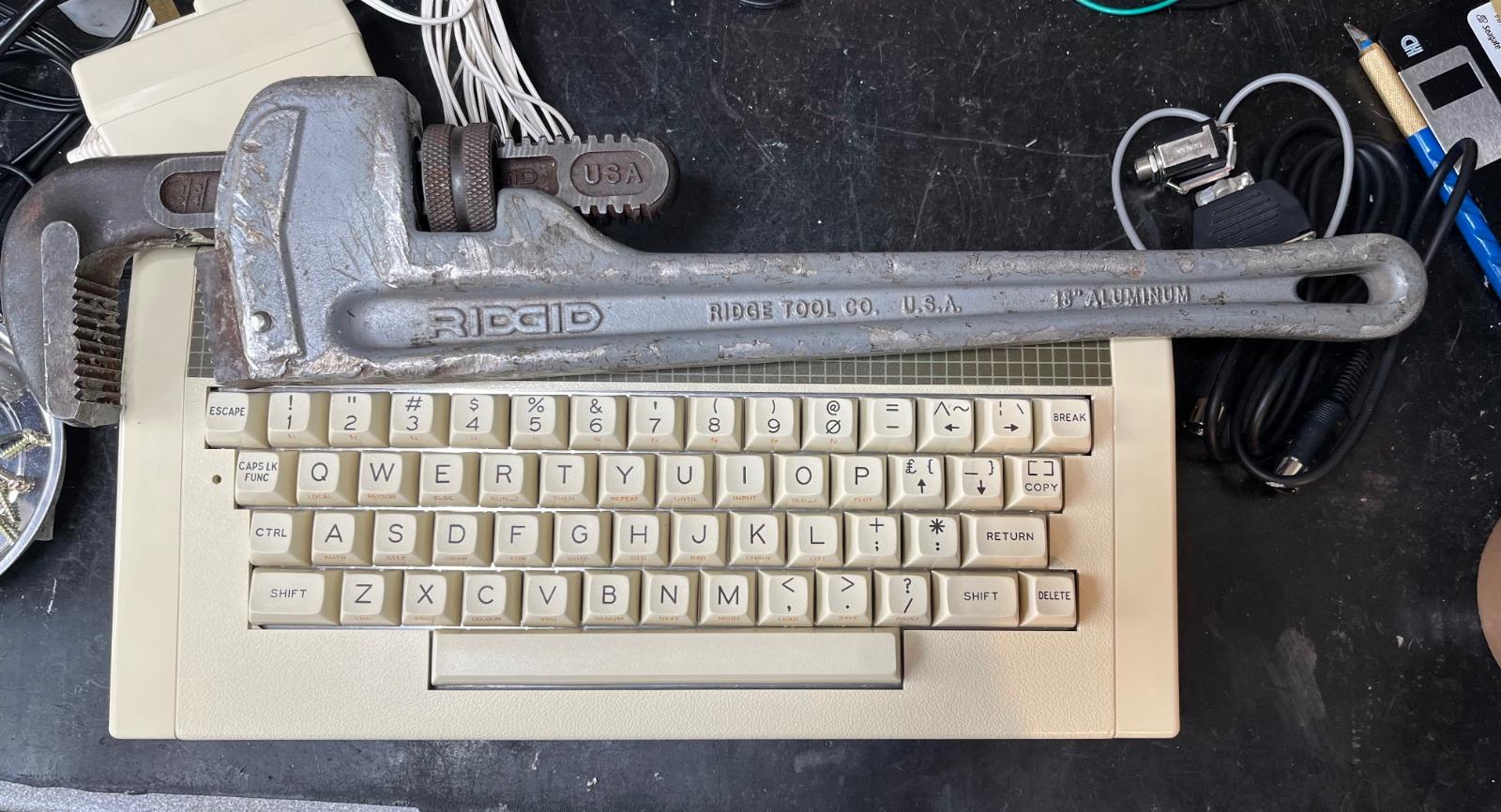

This arrived in the post today, thank you @mrbombermilzy
As you can tell I have all my tools to hand to take it apart and get it working again. But if that doesn’t work I have a pair of 36” stilsons and a large axe in the shed for those stubborn case screws.

So I plugged the electron in, got the Scope ready, logged off from my work pc and BEEP, I about jumped off my chair.
It will now boot to desktop but takes a very long time about it, so I think I shall be checking the reset circuit first. PSU seems ok at 4.96V and -5.02V.
Edit:
Whoops, if you plug the keyboard in it now boots right away, time to leave it off for a mo but still check the reset caps. Only other thing I've done is to check and clean the ULA.

And it won’t go wrong at all now, well that was disappointing, I was hoping for more of a challenge.
It does look lovely and clean inside too, so now I’m off to try and find a tape lead for it.

Is that wrench for percussive maintenance?PhilC wrote: Fri Jun 09, 2023 3:43 pm So I plugged the electron in, got the Scope ready, logged off from my work pc and BEEP, I about jumped off my chair.
Edit:
I would have a look at the electrolytic caps in the internal part of the PSU, obviously there's not much to be done with the external AC part of the PSU. Mine were a mess and had to be replaced.

Yes, whenever you can't find a hammer, use your Ridgid Stilsons, larger bang, the bigger the pair. This only needed a little tweak, so that 18s came outrubber_jonnie wrote: Fri Jun 09, 2023 4:09 pmIs that wrench for percussive maintenance?PhilC wrote: Fri Jun 09, 2023 3:43 pm So I plugged the electron in, got the Scope ready, logged off from my work pc and BEEP, I about jumped off my chair.
Edit:

I believe what you need is an ElkSDPhilC wrote: Fri Jun 09, 2023 4:08 pm And it won’t go wrong at all now, well that was disappointing, I was hoping for more of a challenge.
