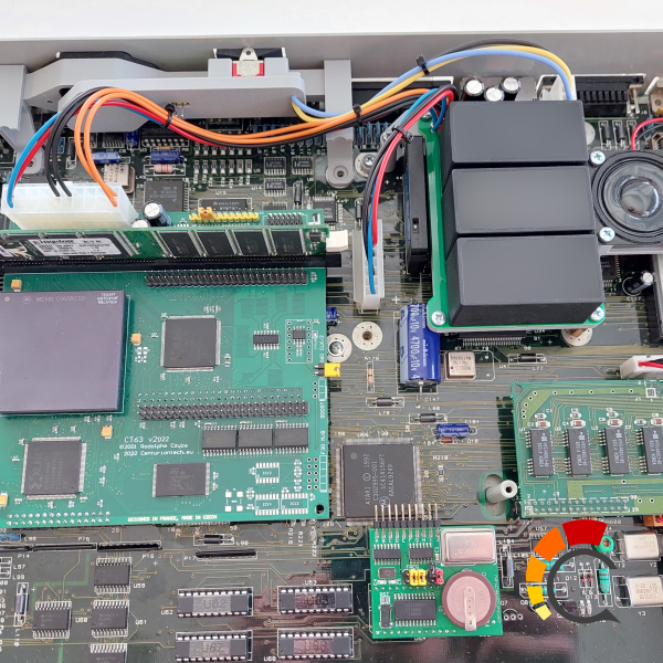

That said, it's hard to see how user error fits here. This is from Centuriontech's own website:
Uncompromised safety. Current design hides all AC wiring from your reach, preventing accidental contact with high voltage. This allows you to work on uncased unit, safely, even under power.
And this is how it is all enclosed:
If all the mains wiring is hidden away from the user by design, there is very little left for them to get wrong. On top of that, more than one person has now reported problems, which is not what I'd expect from individual installation mistakes. So I'm not dismissing it, but the evidence so far points more towards the design than the fitting. I'll report what I find either way.

exxos wrote: Mon Oct 05, 2026 7:49 pm And this is how it is all enclosed:
With the exception of the switch, which makes me itch, that otherwise looks like a very smart and solid design, TBF.
Although I might question the tight spacing of the power bricks. Not related to this issue, I fancy, but do those things get hot at all? Would there need to be a bit of separation for convection to do its job?

Badwolf wrote:With the exception of the switch, which makes me itch, that otherwise looks like a very smart and solid design, TBF.
Just to clarify, I only posted that picture to show how the unit is meant to be enclosed, in answer to the user error question. It's an enclosure image, so it doesn't show the board underneath the switch, which is where the burning is.
From the photo of the failed unit, the damage appears to be on the PCB around the switch rather than inside it, so I wouldn't put it all down to the switch itself. What worries me is the mains tracks and the low voltage signal sharing the same small area. I'll measure the clearances when it arrives.
Good point on the brick spacing as well. I'll have a look at that while I have it apart, but I wouldn't read anything into it for this failure.

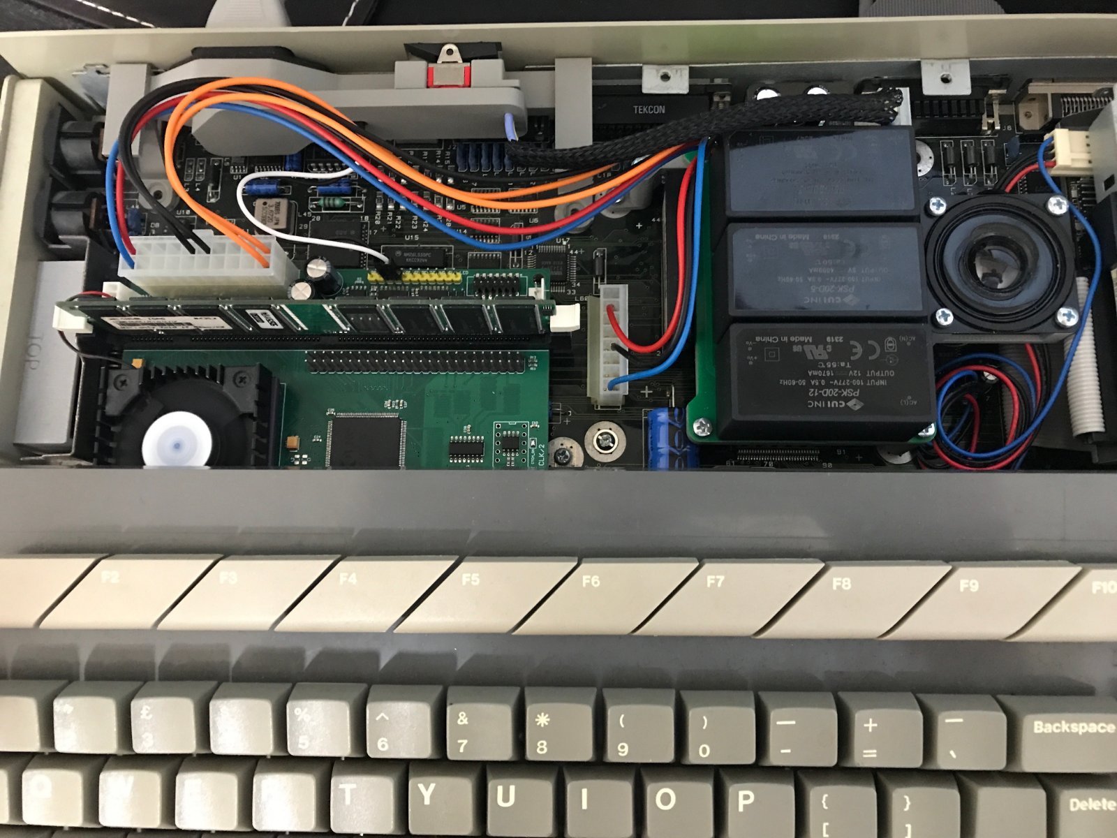

I have the same setup and as you can see, the lower shield is also fitted:
I had no issues so far, but maybe because our 100V is less prone to arcing than higher voltages...
But since this thread has put me off, I will now avoid using my Falcon.
