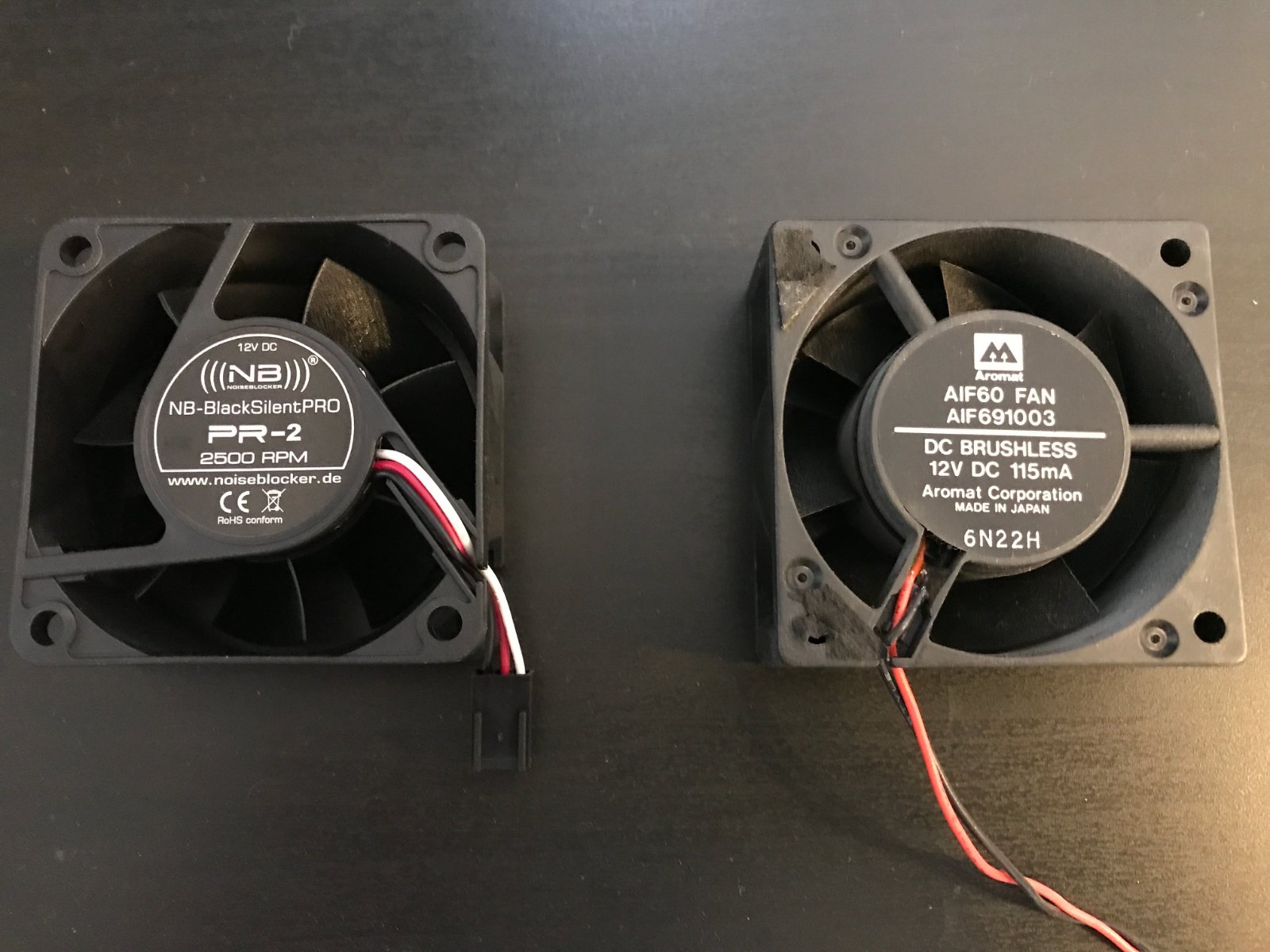

I have finally fitted the new PSU fan.
The beauty and the beast...
And the final result, with cables routed.
The missing resistor arrays should arrive tomorrow, so I can finish the XT CF mini.
