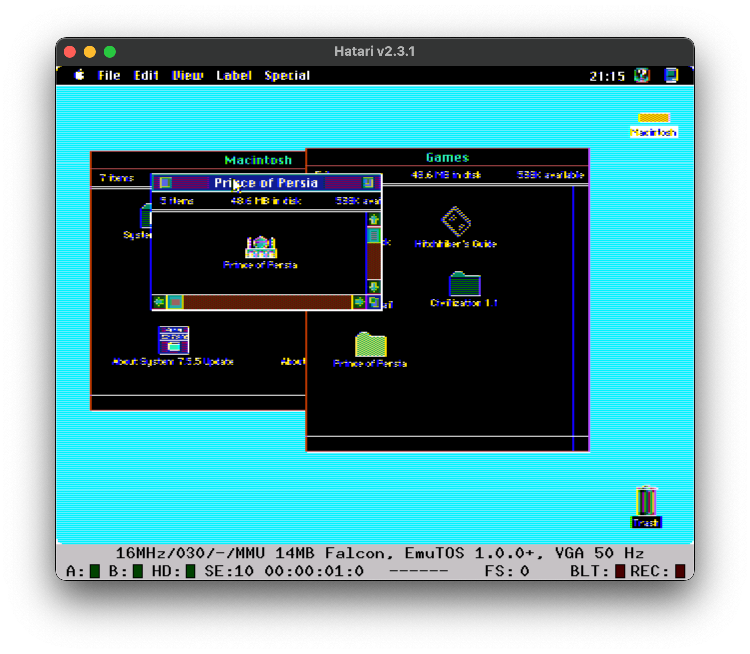

Badwolf wrote: Mon Mar 07, 2022 11:11 am Firing up a PRG version of EmuTOS and skipping NVDI produces a properly formatted screen and highlights that the Mac expects the border to be black. ;)
Wow, yeah that border certainly needs to be black, and luckily for me I'm able to repro it in Hatari :)

All the Mac modes are indeed chunky. From what I can tell most games seems to require either b&w or 256 color mode. I found one 16 color game but that mode is also chunky.
For the palette, the Mac display driver must expose a Control() function and one of the parameters is to set the palette.
On a real Macintosh I guess the actual location is going to be different, and internal to, whatever graphics card it's equipped with.
In Basilisk's case, the ROM is patched to include an Atari display driver.
The driver doesn't do anything fancy in terms of converting graphics(*) just presents the Atari framebuffer as-is for MacOS to use.
When MacOS calls Control() to set the palette, those colours are converted from Mac format (0-255 per channel) to VDI format (0-1000 per channel) and finally vs_color() is called and VDI takes care of updating the hardware palette on the shifter/videl/graphics card.
(*) It could though, and it does have a debug mode where it can convert Mac 8bit mode to Atari 16 color mode.
I made it so I could debug some 256 colour-only stuff in Hatari, but it's much too slow to be usable in the real world, and also broken now :lol:
