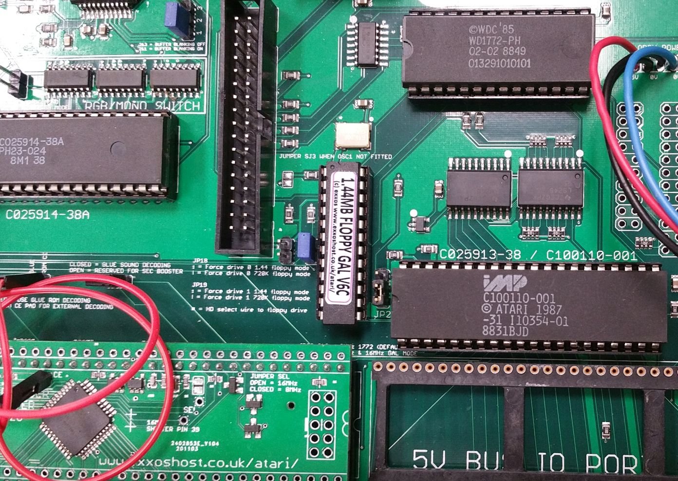

Can you post a image of how you have setup all the floppy jumpers ?

Re: Bikerbob's H5 C1 build
Post by Bikerbob »
Here is the pic.
I re-flowed the joints on the Floppy port, I dont think any were bad, but they all got a touch up.
