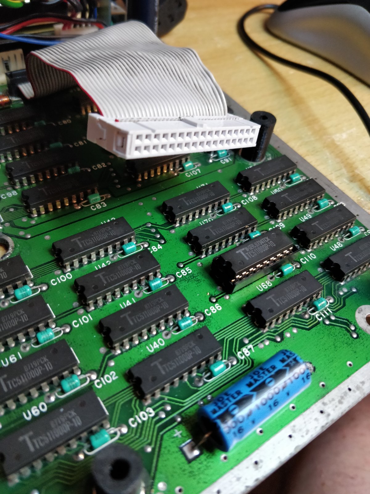

I arrived home to find the chips waiting for me, so I got the soldering iron fired up, and without burning myself I removed U69 based on the previous diagnostics, installed a socket, then the replacement RAM chip as below:

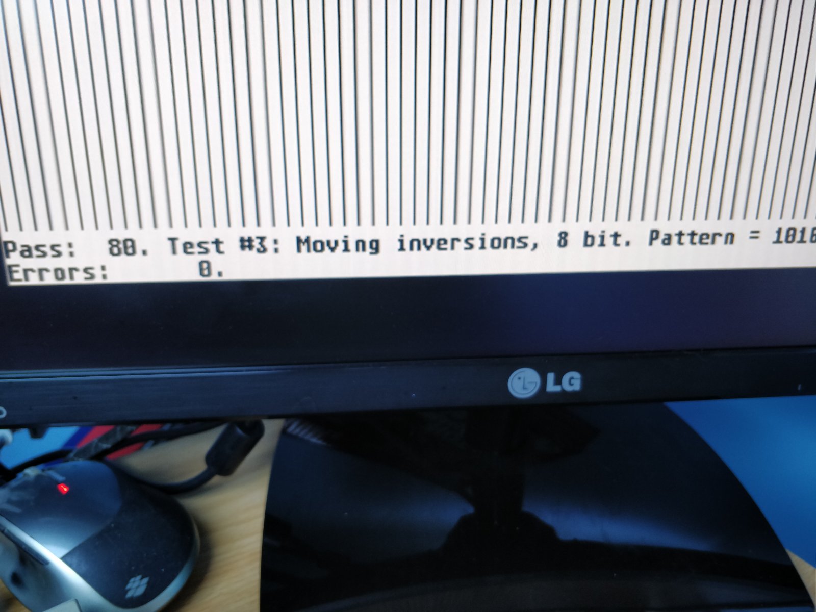

I ran both the diag cart RAM test with the following results:

Big thanks to DoG for all the help re RAM chip vs bit locations, it got me straight to the right chip

Just checked YAART and its 11 passes in with no errors. I may try leaving it to run for longer over the weekend, but looking good

Incidentally, I managed to kick off YAART when I got home, and it completed 40 passes with no errors, so I'm happy with that.

I think I can call it fixed from a RAM point of view
