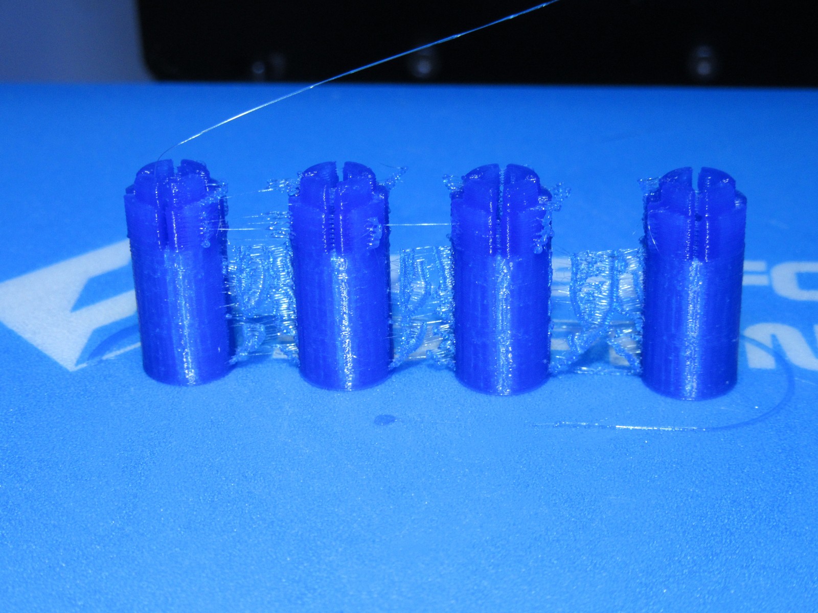

Re: Floppy Support
I printed 4 thinking it would print the top layer better as it would have more time to cool... But I ended stringy mess :-\
I was actually printing at 0.12mm heights, so I changed it to 0.2mm and increase the filament the traction a little bit more.. And these printed out almost perfectly...
The overall finish is not as smooth on this setting, but print time is significantly reduced.. And these print out perfectly fine for usage anyway.

Re: Floppy Support
Excellent! Next question, do they fit the mainboard ok?
Re: Floppy Support
Basically yes, but due to the sloping ends they are a loose fit now than before.rubber_jonnie wrote: Fri Nov 16, 2018 3:27 pm Excellent! Next question, do they fit the mainboard ok?
