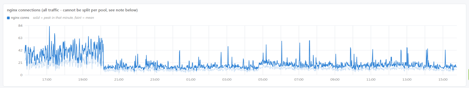

Posts: 29662
Re: Server updates
I said a few weeks ago I could see this coming, and here we are. Detecting bad traffic gets harder every month, not easier, and I want to be straight with everyone about where I think this is heading.
I've still got a couple more tricks up my sleeve to keep blocking the worst of it, but my honest prediction is that over the next few months the detection side of things is going to start losing ground. Even with AI helping build the detection logic, I think it's a losing battle in the long run, because I strongly suspect AI is now being used on the other side too, to help evade exactly the detection it's helping me build. Some botnets are still fairly dumb and easy to spot, whole networks of them in fact, but the landscape on the clever end is shifting faster than I've seen it shift before, and it feels like it's basically becoming a game of diminishing returns.
That's the whole reason behind the guest versus member resource split I mentioned a while back. Guests and members each get their own chunk of server resources. If the guest side gets overwhelmed, guests will see the forum struggle or go down. Members will not, because the member pool is separate and protected. The honest version of the endgame is that I'm prepared to let the guest and bot traffic fight it out amongst themselves on their own pool of resources, rather than keep pouring endless effort into a fight I don't think stays winnable, and put my energy into keeping the member side solid instead. I think it's a case of when, not if, the guest pool starts taking real hits over the coming months, so if you're reading this as a guest, please sign up for a proper account. I can't promise guest access stays reliable indefinitely, and I'd rather you heard that from me now than find the forum unavailable later with no warning.
The network-level blocking is still doing its job, picking up new bad networks on ordinary traffic every day, so it's not like nothing is working. But the trend over the past year has been unmistakable: the bots keep getting better at evading detection, and I'm running out of road on that front.
I'll also say this is a battle on two fronts, not one. The bot traffic side is already effectively a full-time job on top of my actual job, watching it, tweaking it, working out the shape of each new wave. But there's a second front opening up: accounts signing up in bulk that get through every defence and every signup check we have, and then it becomes a daily grind working out whether a given post is a genuine person or not. Our moderator team are very on the ball with this, but I can see that side alone turning into its own full-time job within the next year, running in parallel with the traffic side rather than instead of it.

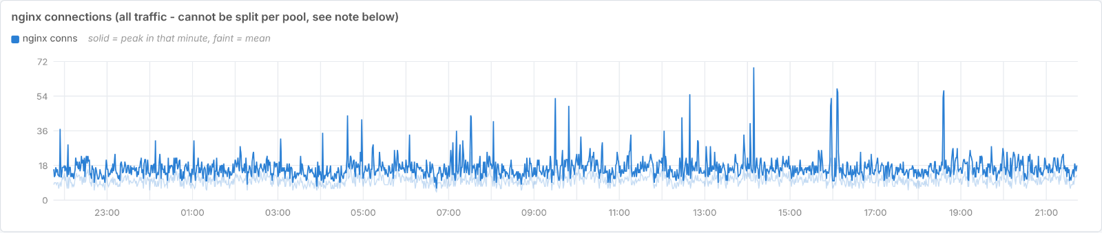

Posts: 29662
Re: Server updates
The connections have been pretty quiet the past few weeks now.. The average is just 5 connections per second overall.
Most traffic doesn't even hit the backend anymore. So php-fpm and mysql etc are prettymuch idle all the time now.
Most bad traffic gets dropped at various levels. Worst offenders get a hard block. My detection scripts still seem to be holding up as well. But doesn't seem to be much traffic hitting us now.. Hopefully it will stay that way..
