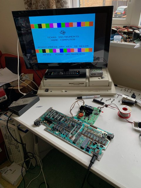

Looks like the TI 99/4A has bad 4116 display RAM.
When I very first turned it on it was OK for a couple of seconds and then more and more of the display became corrupt and stayed corrupt in that way when power cycled. Not surprising. 4116 RAM is notoriously bad.

Re: General Stuff(tm)
Well, pulled the machine apart this morning and replaced the bad video DRAM.
One chip was obviously bad with the output being a few millivolts. Replaced that and things got a bit better. One other chip was behaving slightly strangely when viewed on the 'scope so replaced that and...
Happy machine!
My experience with the Memotech MTX helped here as it uses the same graphics sub-system so it was obvious to me what the fault was.
Happy machine!
