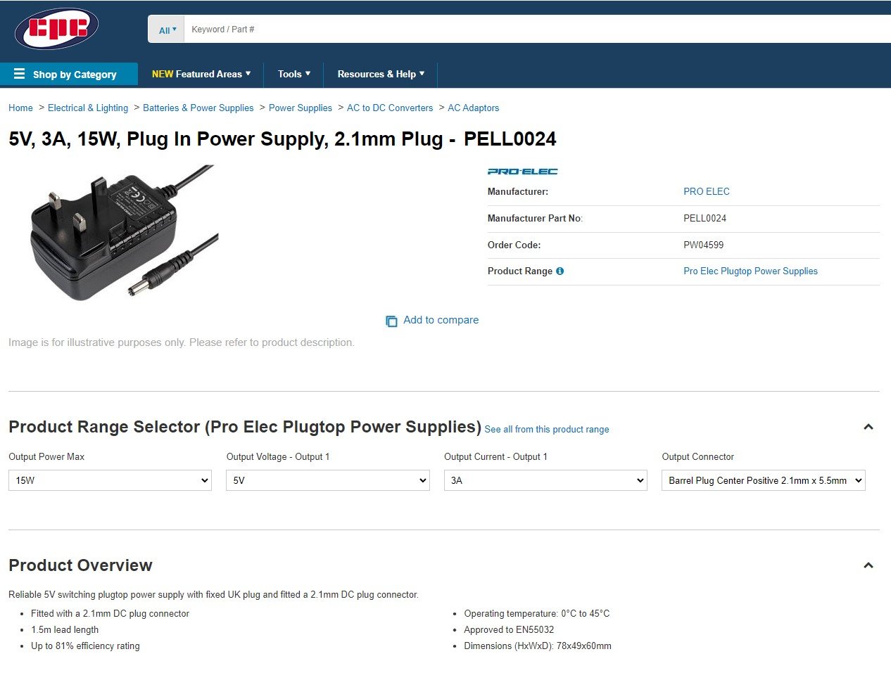

My Digital Receiver had no power supply but had 1.2A MAX written next to the barrel socket:
So I bought this center positive supply from CPC:
Screenshot 2022-08-01 000832.jpg (138.61 KiB) Viewed 1563 times
Is this the right approach or could I have gone with higher amps?
Would the TV box fry itself or would it 'know' what's going through it?

Cosmic Puppet wrote: Mon Aug 01, 2022 12:13 am My Digital Receiver had no power supply but had 1.2A MAX written next to the barrel socket:
It should be OK, but IMO I would go with a 2amp PSU. As they never normally give the full output of what they quote. Plus your box saying 1.2A you should take with a pinch of salt as well. It could be a bit higher . Nothing wrong with giving stuff a bit of headroom, you could use a 5amp one with no troubles either.

Thanks Exxos. I was worried about frying the TV BOX. The adapter does get quite warm.

Cosmic Puppet wrote: Mon Aug 01, 2022 12:33 am Thanks Exxos. I was worried about frying the TV BOX. The adapter does get quite warm.
Its probably running on its limit. PSUs generally really start suffering efficiency wise generally after like 75% of its rated current for example. I guess a general rule would be go with 1amp higher than you actually need.
Would this 2.2A one I'm currently (no pun) looking at be a good choice?
Don't want to go higher than I need with energy coats an all that lol
*edit* will have to go with the 2A one as the barrel plug is the same so I know my adapter will work.

I had a look on my other TV box that doesn't work and it's wall plug has a 3A fuse in it.
Finally went with this:
