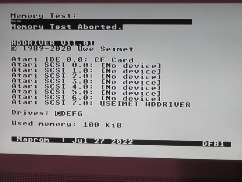

50MHz with MAPROM :)

Next problem is that MAPROM doesn't seem to like being loaded from AUTO :shrug:
