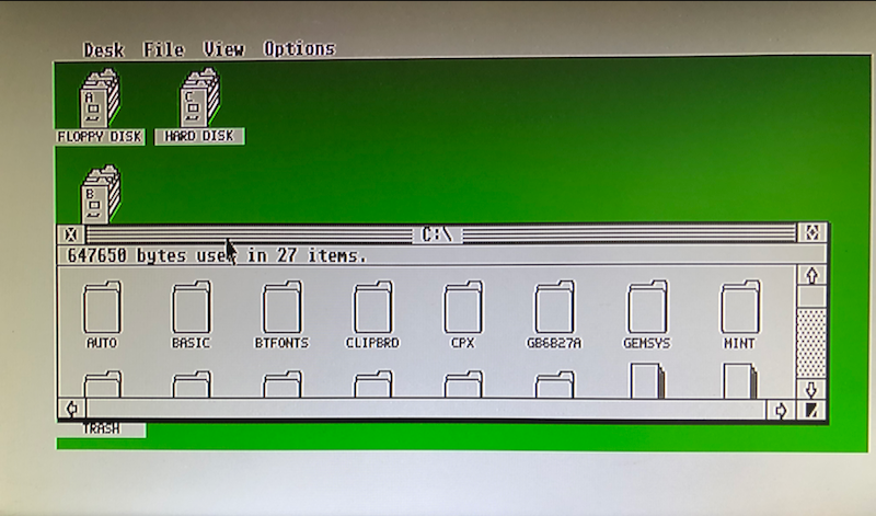

Now I did something similar but with the DMA. Was pondering and glanced at my STM 520 wall art and noticed the DMA was socketed.
I pulled it out and placed it into the STF Remake and put the WD1772 back to normal. I got drive C but there are more oddities.
Now its reversed Floppy isn't working when HDD is plugged in

Icky wrote: Fri Oct 12, 2018 4:37 pm Now its reversed Floppy isn't working when HDD is plugged in
:lolbig:
Its like some combos of DMA and 1772 are not liked, but the "conflict" should be resolved with removing the 1772 databus :roll:
I sent you a new 1772, so you can try that in your board... It could be possible the 1772 or DMA you have might be faulty ?
