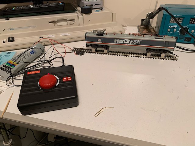

A couple of weeks ago I won an auction for an old Hornby APT train and it arrived today.
Whilst I've been getting my dinner I've also been testing, cleaning, re-greasing and oiling the power car. Goodness it needed a clean. Way too much oil had been used in the past and it had partly dried and caked everything, including inside the body.
Anyway, it's back together than being run in again
