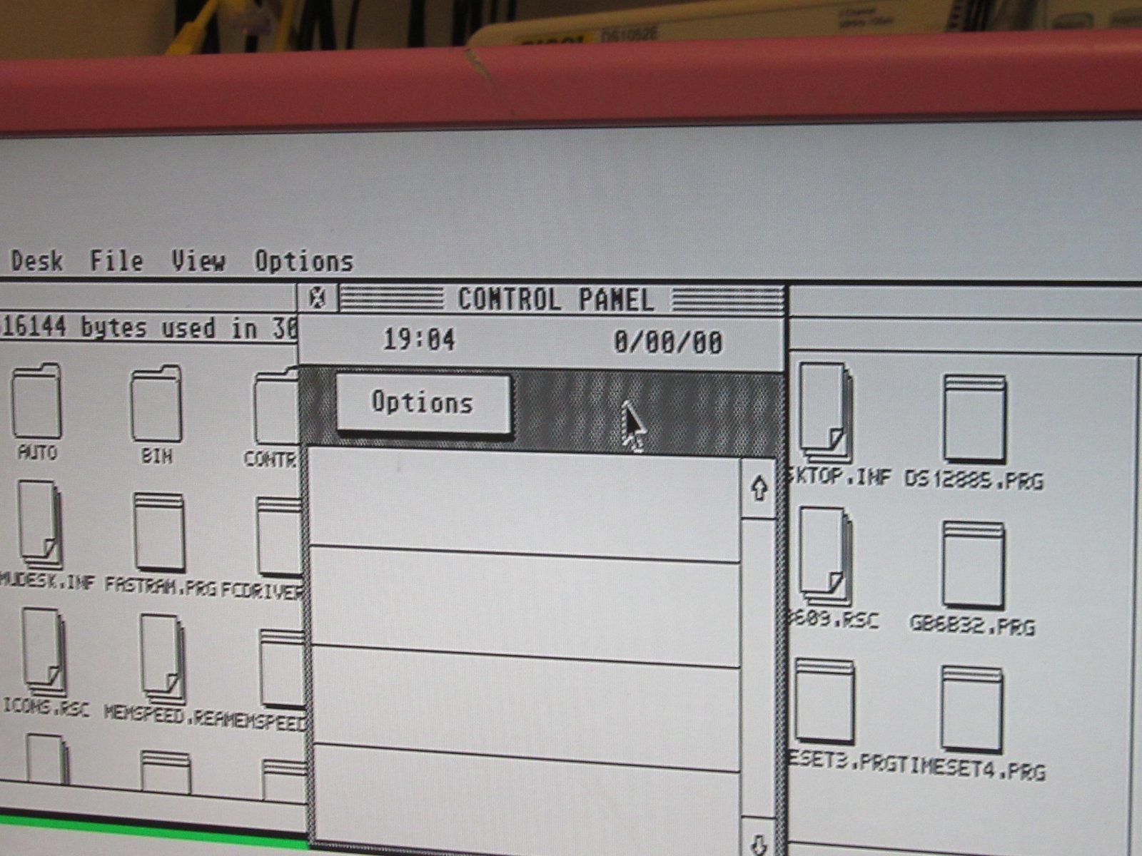

Been pulling my hair out all day because my previously working flashy clock board decided to start coming up all sorts of weird faults :roll:
I thought I might have broken the firmware or something in a later version but after much investigation there is pretty much no real difference between the previous board and the new one..
The previous version 7.0 works fine in the H5.. The latest 7.1B did not, as shown in the image above.
TL;DR - I resoldered the header pins and all is fine again..
So another black mark against PCBWAY.. I can honestly say they are definitely in the top companies in my PCB blacklist now. I've dealt with some pretty bad companies over the past 20+ years, but badly soldering 2 totally different orders now.. and I am having to fault find every board as well.. I thought JLC was bad, but PCBWAY is a order of magnitude worse it seems. :roll:

Of course this is as good as I can currently make it. Because as said previously, Control Panel seems to get the date from the keyboard RTC which isn't compatible with flashyclock. And it's not y2K compliant.
Programs which access GEMDOS system time is fine as shown in the image. But the XBIOS calls are for the keyboard RTC which is basically "broken" these days.
