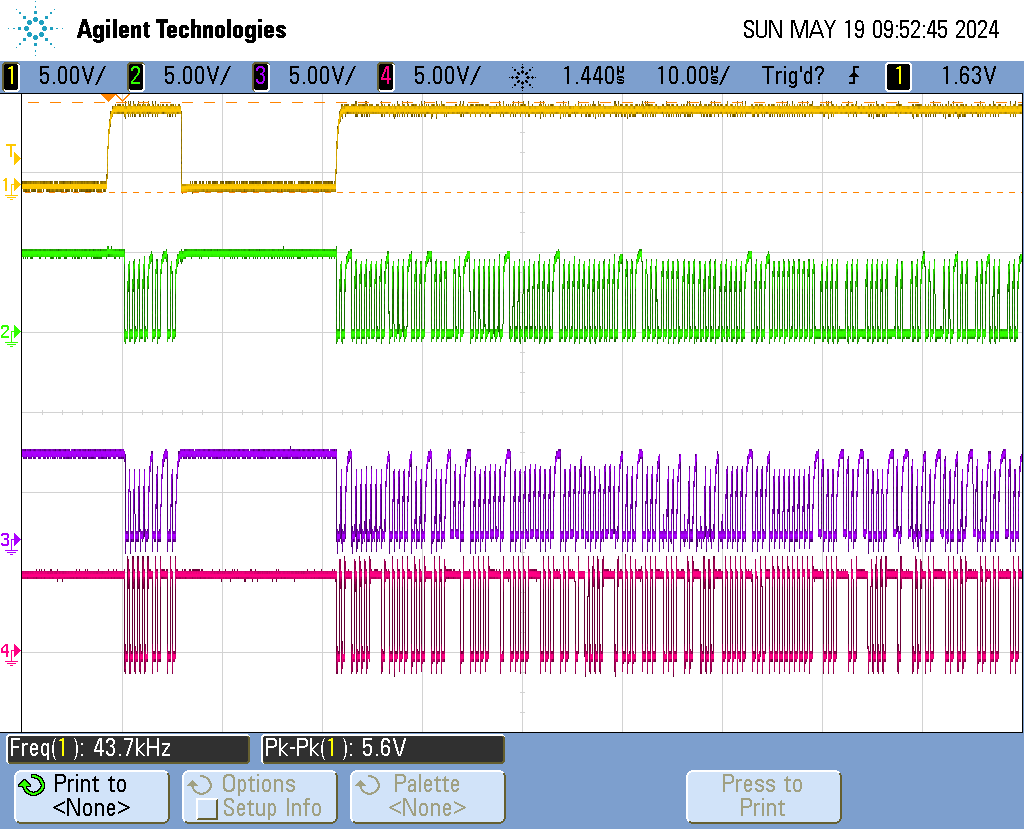

Just managed to sneak a few minutes on looking at the signals on this second H5C1 at boot to compare with the first H5C1...see below:
yellow = reset (68k expansion socket pin 18) - triggers on rising edge
green = AS (68k expansion socket pin 6)
blue = DTACK (68k expansion socket pin 10)
pink = ROM_CE (JP 13 pin 1 or 2 - which are shorted together by jumper link)
First H5C1 at boot - notice that I'm getting two rising edges on Reset (using the reset button for generating the reset)
Second H5C1 at boot - first image is the total activity, second is zoomed in on the first burst of activity.
So, the behaviour of the two is very different (but maybe sort of matches the first bit of activity of the first H5C1 before the second reset???)
Is the extra reset signal on the first H5C1 normal?
I might have to get my H4 board set up to check on that (as that one boots & floppy etc. work OK)...
I will look at the general signals with the processor removed on the second H5C1 but didn't have time for this today...

- Posts: 29861
- Joined: 16 Aug 2017 23:19
- Location: UK
Re: JezC - the second (and laST) H5C1 build
If I remember rightly one of the first instructions run in TOS is a reset. I asked about that before. So the double rest is normal.
As your not getting the double reset, your not running ROM. Trying to run TOS206 would probably cause the same symptoms.
Again you need to remove the CPU and hardwire that H4 test. You may have a bad bit on the databus and you need to read back what the CPU is seeing from ROM.

Thanks - good to know.exxos wrote: 19 May 2024 11:44 If I remember rightly one of the first instructions run in TOS is a reset. I asked about that before. So the double rest is normal.
:thumbup:
Yes, still planning to do this but like you time is often limited - this was a simple & relatively quick check to swap the EPROMs between the two H5C1 boards and see if anything changed (which it didn't - so I know the EPROMs are both working the same at least).As your not getting the double reset, your not running ROM. Trying to run TOS206 would probably cause the same symptoms.
I also captured the scope images for future reference as I'll most likely forget what they looked like before I get the next chance to diagnose further...
