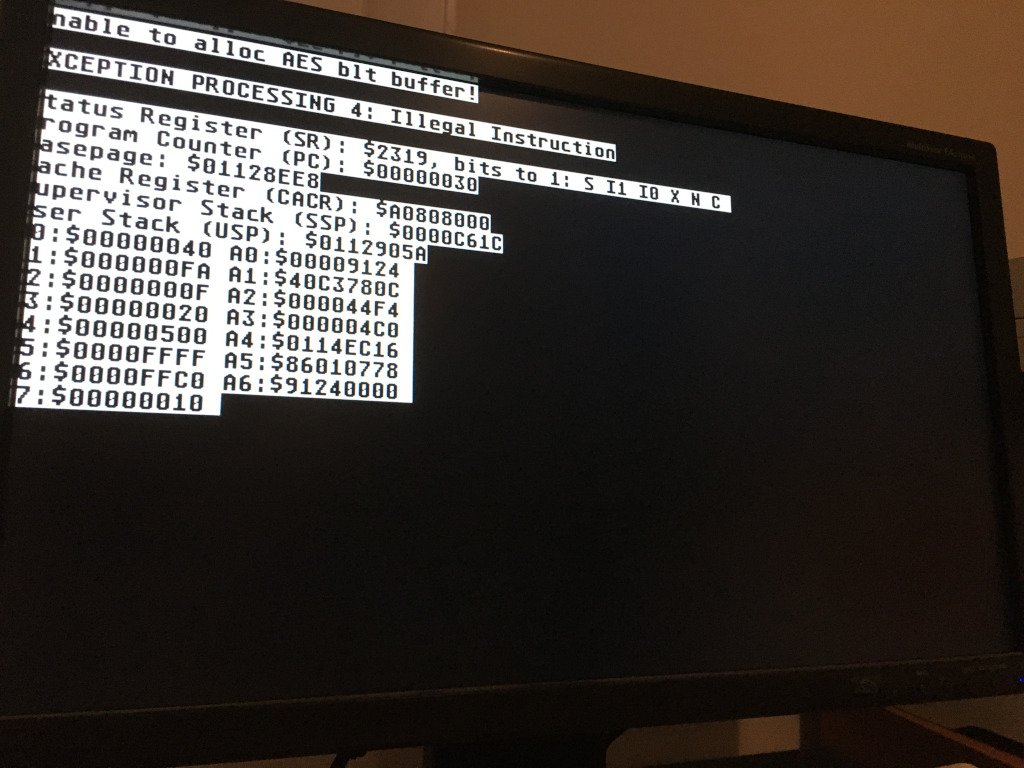

So it almost works!
It detects the card and runs the bios etc:
Then it displays the boot screen on the Radeon and starts to boot:
Until...:
Edit: Seems like it's just incompatible with NVDI. So I need to remove NVDI from the Auto folder. Wow, this thing is fast in gembench!
There is also a 2nd problem, I get a parity error depending on how I position the card, so perhaps there is a bad connection somewhere.
