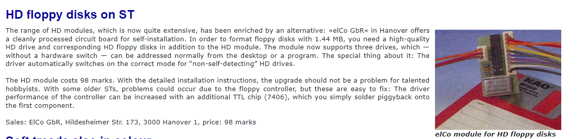

http://www.wrsonline.de/pdf/HDKit.pdf
German, can't copy text to translate
but that only seems to mention pin 19,20,21. It would have to mention pin 14..
Re: TOS patch for 1.44MB floppy support ?
The Elco module all I can find really is there was a CPX and ACC for it.
I can read German well enough. But is that the ELCO kit? It doesn't say ELCO anywhere, but yeah, maybe that's the PSG connections it uses (too).exxos wrote: Thu May 26, 2022 1:31 pm http://www.wrsonline.de/pdf/HDKit.pdf
German, can't copy text to translatebut that only seems to mention pin 19,20,21. It would have to mention pin 14..
Not elco no. Was just mentioned in the FCOPY docs about the PSG on the german forum.troed wrote: Thu May 26, 2022 2:30 pm I can read German well enough. But is that the ELCO kit? It doesn't say ELCO anywhere, but yeah, maybe that's the PSG connections it uses (too).
I've not found anything on the elco.
