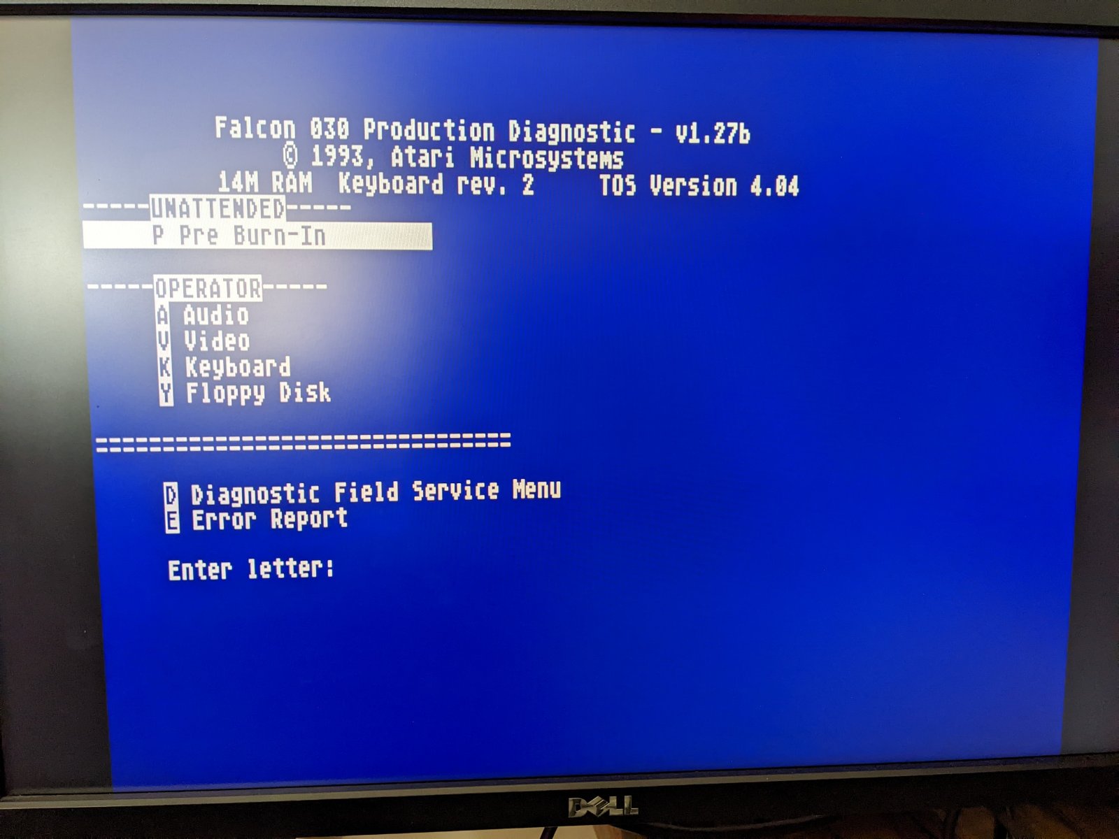

@Badwolf
Here we are, CPU at 50mhz:
All working great, next time for TT ram :)

Steve wrote: Wed Apr 20, 2022 10:17 pm @Badwolf
Woooohooo!
First board that's confirmed working outside my own Falcon.
Well done Steve! :girldance: :girldance: :cheers: :cheer: :cheer:
