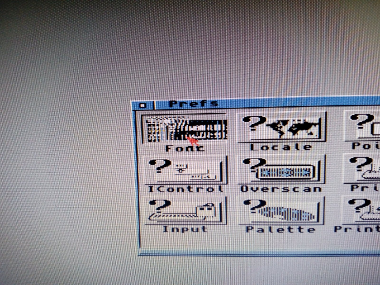

Right found the INT2 jumper....that made no differnce....also the second image on the icons are still corrupted...and still locks up if you press the right mouse button for the workbench menu.

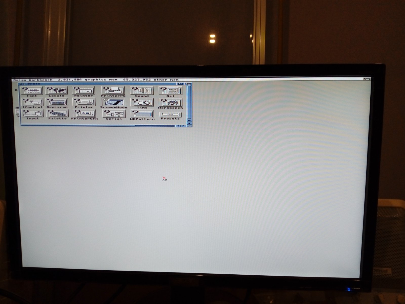

Below are pictures of the Icon Graphics Glitches.....Mouse Pointer Glitches.

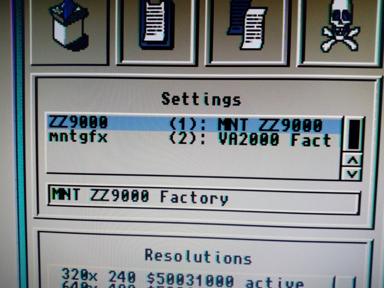

Then Further Down.....P96 Prefs that have the Va2000 in the Card list(deleted this entry...made no difference)

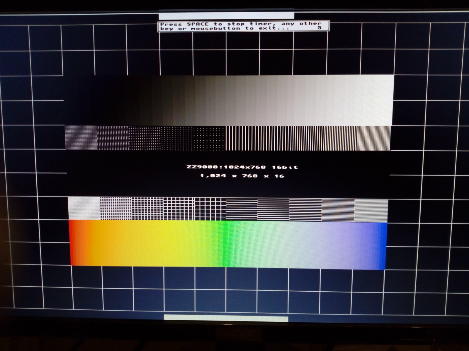

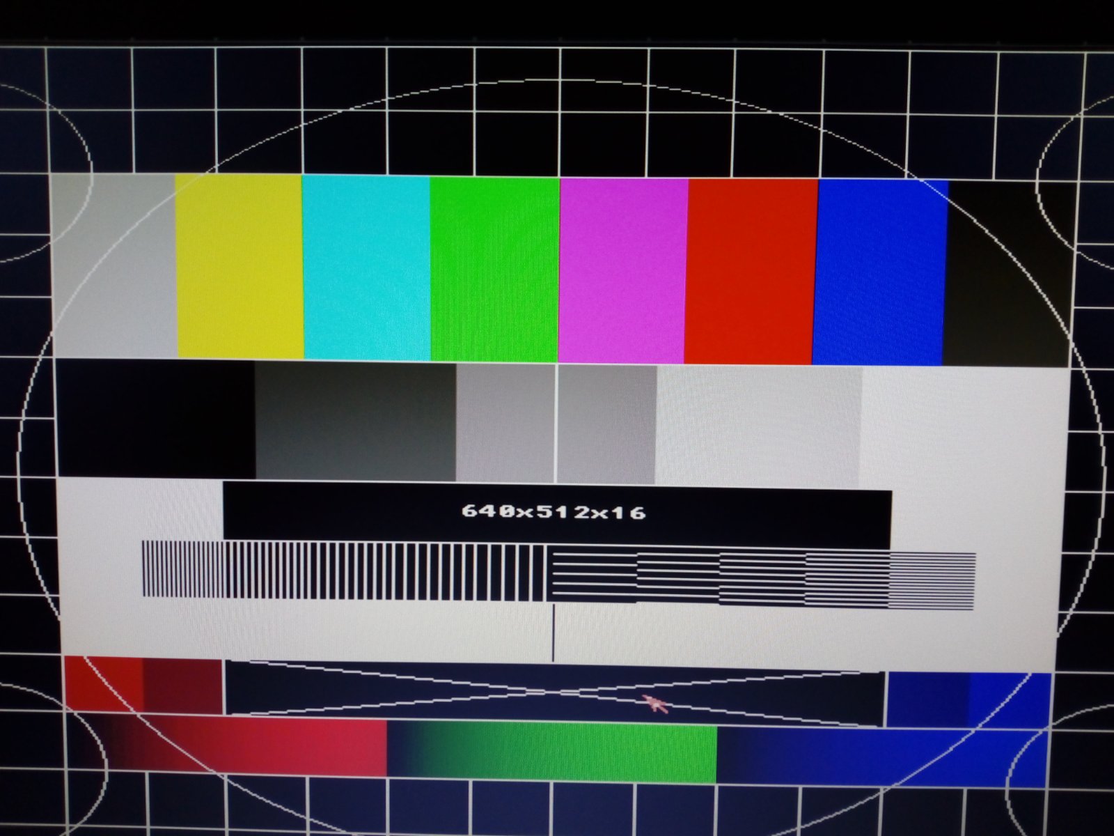

Then the "test screens" from the OS3.1.4 Screen Mode....When I test them there is NO graphics Glitches at all.

I'm thinking its an Angus thing too.
The only time I have seen graphical corruption like that, was when my A2000 Angus was causing problems and needed a fibreglass pen over the pins to clean them up. Then the problem went away.
