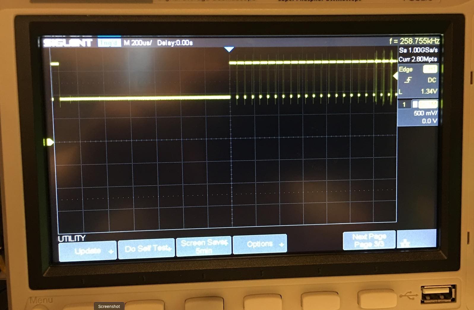

Took a shot of pin 6 of the video connector. If the blanking pulse level matches the video level as shown on scope the H4 video is best it can be. If the pot is changed to increase the voltage the H4 screen blacks out when then the blanking pulse is removed. When the blanking pulse voltage is adjusted toward zero the blanking pulse grows in amplitude and the H4 video gets more washed out. Maximum video quality is achieved when the blanking pulse is the same as the video pulses.

Ok, was very interesting. With the three colors floating with no cap the video is exquisite, the white is a truer white and the contrast is better. I'm going to leave it this way.
With a 33 pf cap connected to the open 3 analog inputs the video gets unusably dark. And the video green line shown at pin 6 of the video connecter as show below now sucks, see below image. Unable to measure voltage on cap as it causes horrible oscillations in the voltage and video. Didn't like scope on x1 and on x10 there's not much left to look at. Its extremely happy with nothing connected to those inputs.
