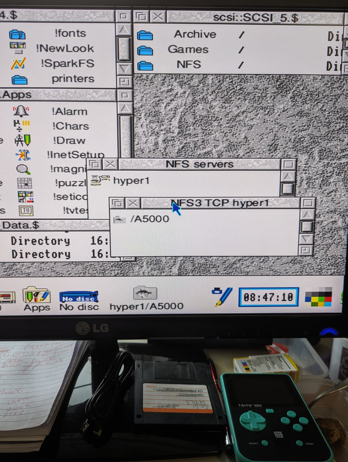

Aaaand SUCCESS!!!!!
Here you can see 3x NFS3 shares on my Windows 2016 server named 'Hyper1':
You can also see I am connected to the one called A5000
The settings on the Windows NFS share are as follows:
And permissions are set to read/write.
The result is I can simply supply a UID and a GID and connect as an unmapped user. I can read/write to the NFS shares and copy files from them. This is a very happy day for me
