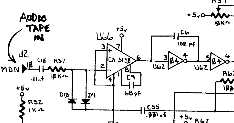

It's a good first step, but I'm not out of the woods just yet. I also need to get the cassette input working, and it isn't...
So this is the first stage of the cassette in port, and testing is quite simple as it goes.
First you jumper pin 9 (AUX) and pin 10 (MON) of J2 together. This connects the AUX out to the cassette in.
Next comes a small testing routine:
10 PRINT "U";
20 GOTO 10
SAVE then enter
RUN then enter
This just prints U on-screen, but due to the weird way SAVE works, it can be used to generate output from the cassette port.
SAVE is weird, because what you do is type the SAVE command into BASIC and then hit enter. The machine changes into SAVE mode. By then typing LIST and hitting enter, it lists your program and sends the data via the 6850 to the cassette port. You can't save a program by name, such as 'SAVE "PRG_NAME", it doesn't work that way.
Very odd, but it helps us here because we are printing "U" to screen and that is sent via the 6850 to the cassette port as though we were listing a program to save it, so what's coming out of AUX is going straight into pin 10, the monitor jack.
However, looking at U66, I see input at pin 2 which looks great. Pins 3 & 4 are grounded as per the schematic, pin 7 has 5v, and the capacitor across pins 1 & 8 measures correctly at 68pF.
All fine thus far, but no output at pin 6. So I thought I should check C6 and found that it's 150nF not 150pF. I'm pretty sure this caught me out before, so I'm going to swap it out and see if that helps.
If there's no change, then I guess the CA3130 is dead, another victim of me overvolting the board most likely. Dumb of me I know, but what can you do other than replace what you killed. Let's see if it's the cap first.
