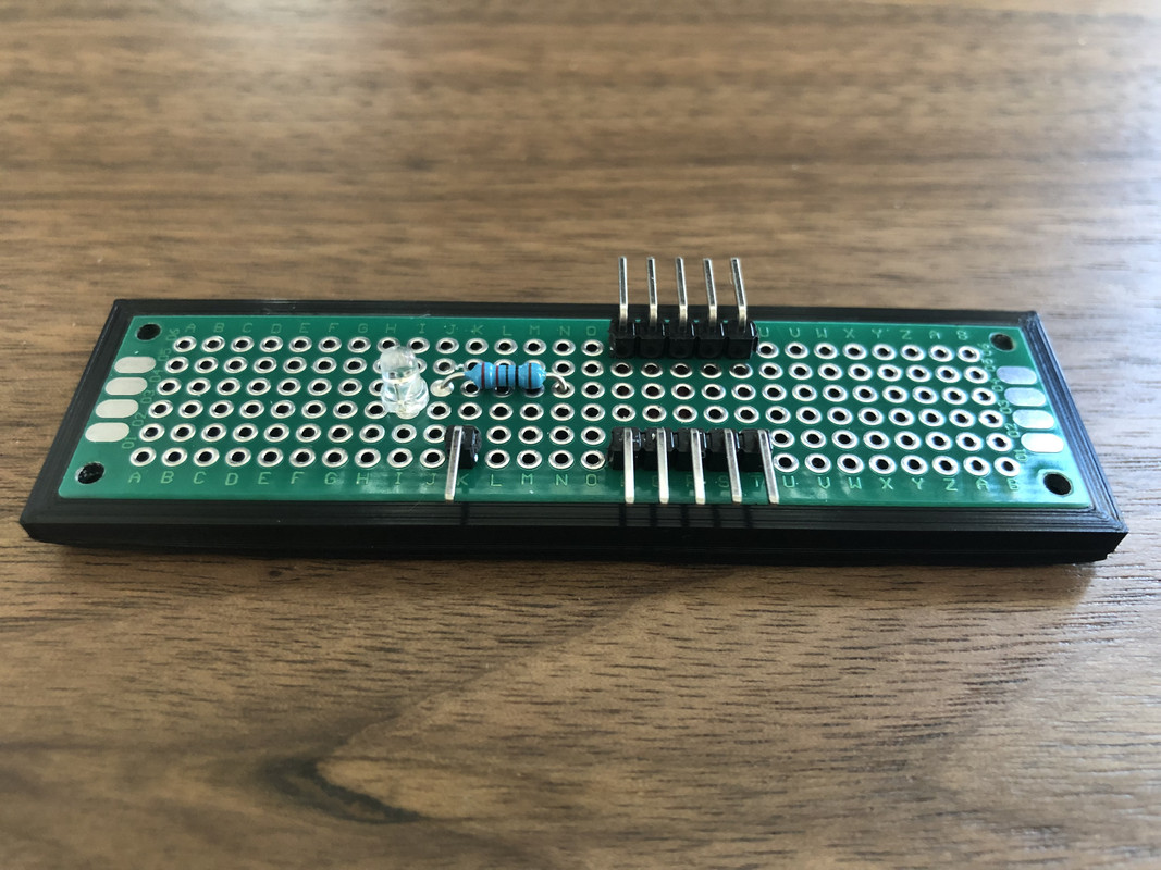

Re: TF1260 stuff
Well, it wasn't that hard after all
A few weeks ago I created this custom board. It gets 5V from the LED board connector on the A1200 motherboard and the IDE activity from IDE pin 39 on the CF2IDE+ adapter connected to the IDE port of the TF1260. The original LEDs still work

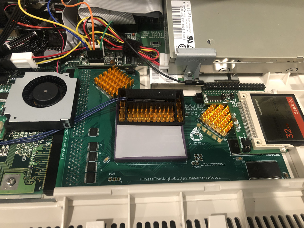

This is what I use as a cooling solution, in case it helps someone else.
Breaking it down:
- Heatsinks 22x22x5mm on the CPU and CPLDs.
- Double sided thermal tape and 0.5mm thermal pads.
- The thermistor going on top of the heatsinks on the CPU is part of the "AmigaKit sensors" that connects to the clock port on the motherboard. The sensor is held in place by a 3D printed thing I created.
- The fan is a 12V 45x45x10mm. It gets its power from the floppy connector. I've a splitter, so I can get power from there quite easily.
The fan is not very noisy to me, even at full speed. I ran Quake for over 2 hours with the CPU (rev.6) overclocked to 94Mhz at all times. I measured the temperature with a laser thermometer, it was around 44-46C on the CPU (don't recall about the CPLDs) with the keyboard and case in place.
If sounds noisy to you, you can use something like a "Noctua silent adapter". It works, slows down the fan, less noise... But I didn't check temperature I've got with it.
Without the fan, the difference is quite noticeable. You can feel the heat on the keyboard itself.
Hope all of this helps someone!
Breaking it down:
