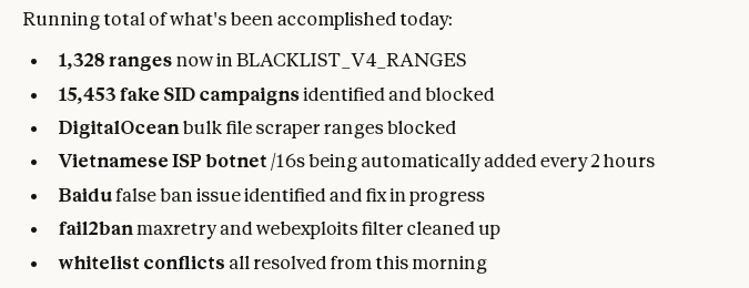

Today's attack is brought to you by a Vietnamese botnet it seems. They are faking session tokens.. So now all the fake tokens are banned. In fact there is huge ranges which are banned when there are a lot of hits in particular sub sets.
The wiki is still under attack from a botnet trying to login and create accounts but this is currently under control. They are all being banned but there are just so many IPs... Ranges get blocked automatically every few hours anyway.

"meta-externalagent/1.1" now banned. I didn't want to start banning "good crawlers" but its not obeying robots.txt and trying to opening up thousands of connections. It's done about 200,000 requests so far which started slowing the down the forum just :roll:
Believe it or not, we still being hit hard from the Brazil botnet attacks. Wider ranges of IPs are now being blocked. These ones are not even showing up in any blocklists yet either! But they are being banned in realtime by fail2ban thankfully anyway.
A script scans the IP ranges every hour and blocks them automatically in the firewall. The idea is , if a botnet starts attacking us, after a hour, those IPs get "grouped" and blocked by ranges. So "in theory" it should "pre-block" ranges which haven't yet started hitting us. It does work, but as attacks keep getting bigger and bigger, scripts and rules have to be refined to keep up. I've done a lot of changes to the server config these past couple weeks to help with it all again.

I have done overhaul today on how the firewall stuff operates. Half of the fail2ban rules running were not even catching any IPs anymore as other rules written later basically took over anyway. So it saved a bit of overhead. I've also significantly reduced the memory usage due to a "oopsie" in the fail2ban config.
SQL,PHP-FPM, Nginx have had a lot of changes made as well. We should be able to handle spikes in traffic a lot easier now. We hit 20,000 guests yesterday all hammering the forum. The wiki was getting hammered along with that facebook bot.. Some of them seem to come from cloud and data centre infrastructures are not even legitimate users ! It was all a bit of a mess !
A lot of rules have basically become redundant because the main attacks of late are all botnets. As I previously feared, they have now moved on to HTTP2 protocols :( Fail2ban isn't really helping with botnet attacks as they all look like legitimate traffic. Though there has been a additional two scripts written where I won't go into the details, but each server request is given a "score" and if that score gets high enough, then a massive IP range gets nuked automatically. That script has to scan the logs repeatedly which takes a bit of CPU but its less CPU than fail2ban was using with all the now redundant jails anyway.
