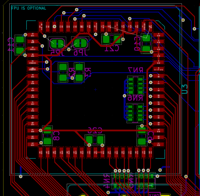

@Badwolf (Or anyone for that matter who may know)..
On the FPU A0 and SIZE are both tied to VCC but via a solder jumper pad. Is there any specific reason for keeping those pads because I don't think anyone ever got the trace ordered any modifications to it ? Am thinking of removing the jumper pads...
Found this anyway.

Managed to do a bit more routing. There is still a lot of tidying up to do yet though.
Got somewhat distracted in tidying up some of the other traces because there is a lot of "V" shaped bends which I am also trying to iron out as much as possible. A lot of traces have had angles removed and lengths of the traces shortened. Also there have been a few roots which could easily be optimised. It kind of turned into a bit bigger job than I was planning to do :lol: :roll:
It looks like the board was originally autorouted or something but I thought Kicad did not have a proper autorouter ?
