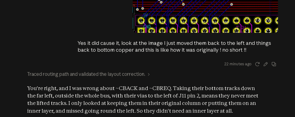

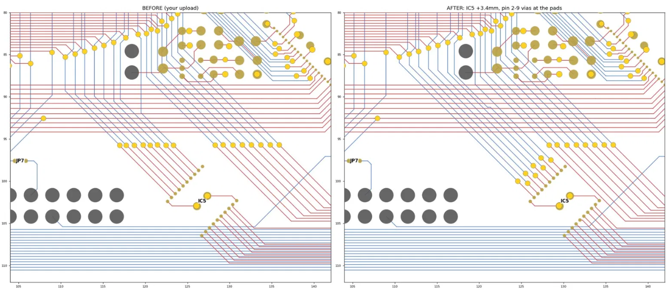

Still trying to get AI to do something "useful" with a PCB. Only thing it managed so far was to move IC5 to the right a bit with moving vias and tracks in KiCad. It actually did a good job. That saved a lot of clicking. But even after giving it answers to routing problems, it still manages to somehow mess it up :roll: You would think in 2026 there be a router which doesn't suck by now !

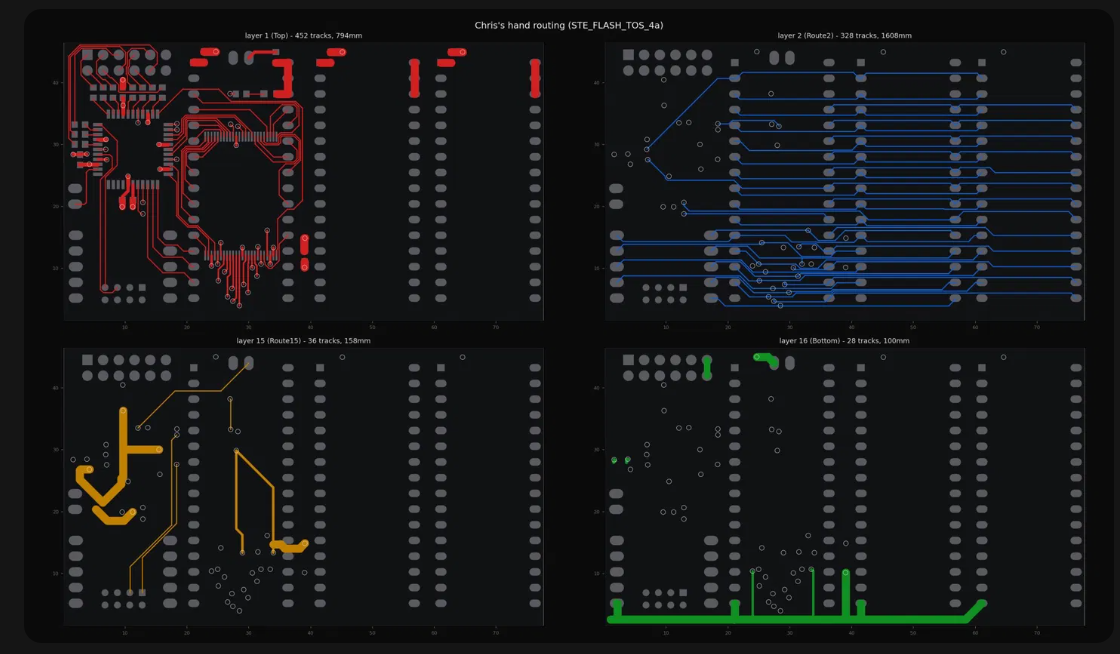

Still trying to train A.I. to route boards as good as I can do them.. This one actually I routed myself and uses way less via's than any auto router has achieved yet.. It seems a bit difficult to try and teach A.I. basically lifelong experience on how to do things...
Apparently there are a set number of algorithms used throughout the industry for routings I'm getting those ported over, mixed in with a "bias" on how I want things done.
I have had some limited success overall so far. Basically took two days to do something I could have probably done in a few seconds. But the point being, because of my RSI pain in my hands, my actual time being able to work on PCBs and such is basically non-existent these days. Plus with not sleeping well I cannot concentrate on such things for long anyway. So even though technically I could do it quicker in some respects, in other respects it would actually take me a long time maybe even weeks.
So even if A.I. takes all day to do something relatively simple, all I have to do is check the end results. Basically the same as what any other router does but I want a router I can control how it routes myself.. Which is the whole point of the exercise..

So far its best effort has used 70 vias vs my 26, and there were several tracks it could not even complete!

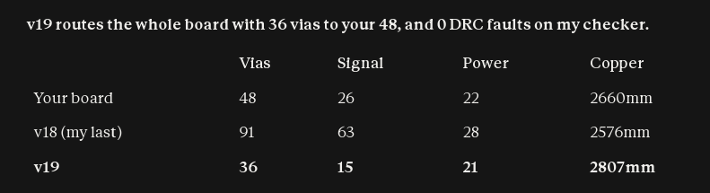

Still trying to get into Ruta PCB as good as me. But it seems to keep coming to the same conclusion that less vias = more unrooted tracks. And the same in reverse, that more vias = less routed tracks. But no matter what combination it goes through, it simply has not got anywhere near how I routed it manually yet.
Even more bizarre thing which it is currently churning through, is that I literally gave it the final board layout, asked it to remove one track, and uses same router to see if he could replace that singletrack, and so far it has basically failed twice and each one of those runs was about four hours long.
I have given it multiple ways and skills on how I do the boards and why I do the things I do, but every single change seems to somehow make things worse not better.

Wait.. what...
I think I have just been out routed ! :shock:
I see one mistake it made where it could save length on a track which will get track length down a fair bit...
