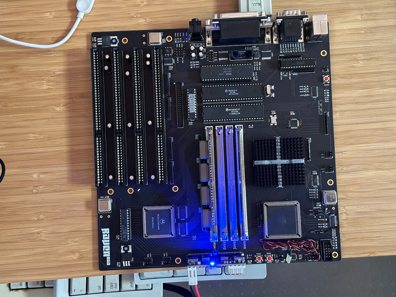

Had a few adventures; mis-labelled Narnia so the smoke test was actually smoky, and some challenges with my first attempts at using solder paste & hot air have meant reworking a few things, but it's up to the point where there's serial output from the monitor.
