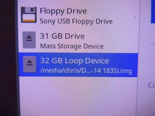

I installed it. But it makes no sense other than list disks. The only option which to looks to do anything is add image, but that just goes in the list like a virtual drive and that's it. There isn't anything much else in the menus other than the normal "about" type stuff. I clicked all over the place, right clicked, can't see anything else in there.
Think I found the problem. The "gears" menu is totally greyed out. Seems I have to format the drive before restoring a image :WTF:
Anyway, it says your image is 640MB to large to fit on my card. Isn't there something like partition magic on Linux ? That would resize the SD card. Then image a smaller one.

I'll try and shrink it somehow. By the way it looks like you've mounted the image (that's the 32gb 'loop device' in your image) Don't have it mounted when you're doing this, it'll get confusing. You just click the one above that, the 31gb sd card 'mass storage device', click the gears and 'restore image'. Select the image and it writes it. No formatting needed.

Steve wrote: Tue Apr 16, 2024 9:56 am You just click the one above that, the 31gb sd card 'mass storage device', click the gears and 'restore image'. Select the image and it writes it. No formatting needed.
Won't let me do that.. All the menu items are greyed out. Only way I could get the restore image menu enabled was to format the card.

sudo dd bs=4M if=steves_image.img of=/dev/sde oflag=direct
This copies steves_image.img to /dev/sde (which is what your SD card was reporting as in the screenshot above -- change if it's changed)
