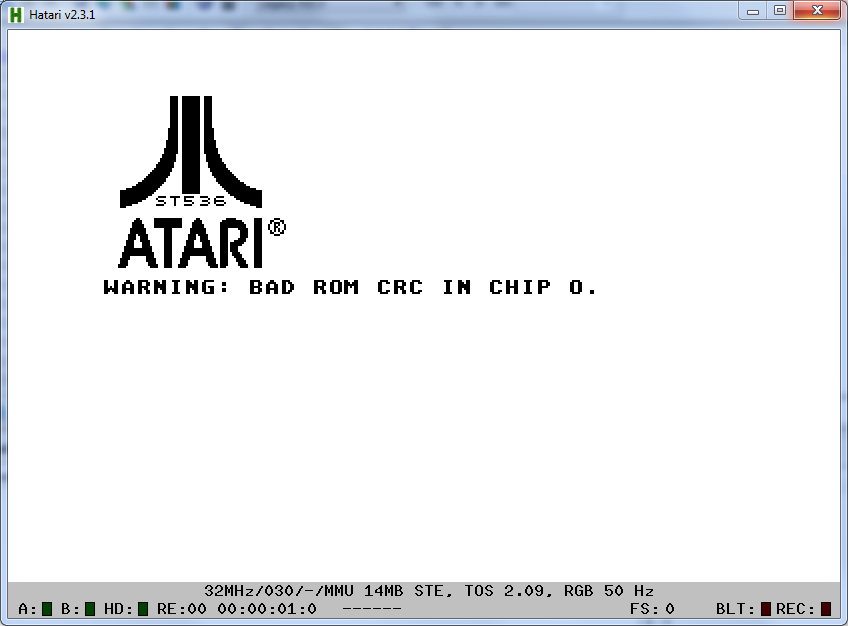

My fairly heavily modded Hatari oddly prints the dashes without reverse text then bombs at the start of the TT-RAM test.
With memvalid it just bombs early doors.
No bus error logged in the console, which is odd.
Screenshot 2022-12-05 at 22.17.57.png (75.51 KiB) Viewed 1558 times
