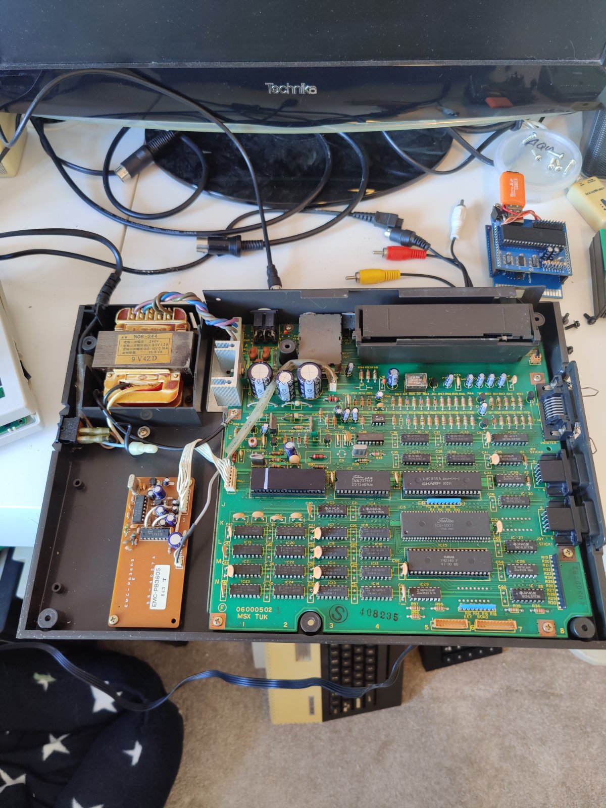

And here is the very neat mainboard:
- mrbombermillzy
- Posts: 2442
Re: MSX Inbound!!
Gosh!
How neat and orderly is that?!
- Posts: 15411
Re: MSX Inbound!!
Clearly laid out by somebody with a penchant for things that are neat and orderly!!
